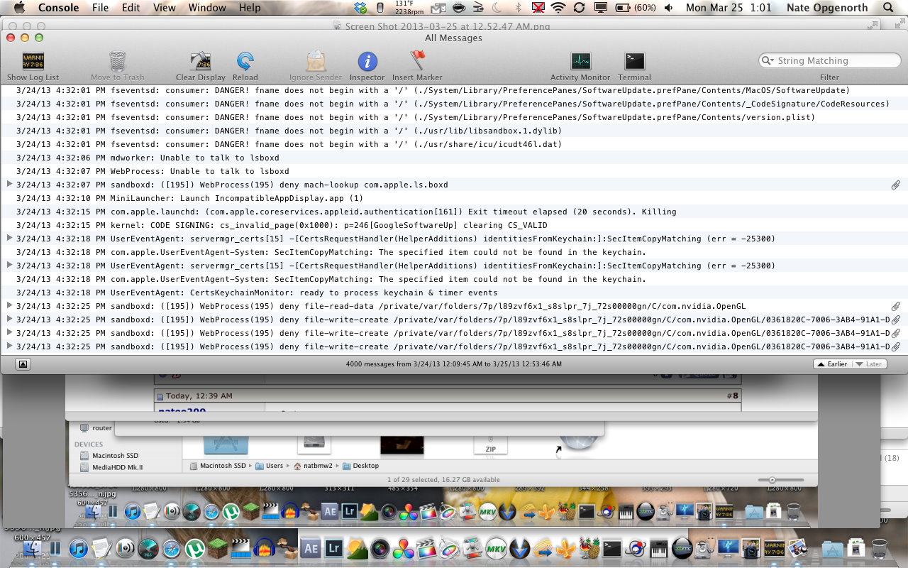

Alright this message is going to come in bits and pieces via editing as I just lost my last two attempts. This is getting frustrating.
It says its running low on memory (RAM) so its forcing me to force quit applications. Page Outs and Page ins are normal but CPU activity is 100% with nothing showing up in activity monitor as the culprit (selecting the view that shows whats cooking up the most). Its my account and its the admin account and ive never had any issues with files writing, read, copying, pasting, now I cant even move, copy or paste files, I cant even delete things. I have had to copy and paste all my unsaved pages and text documents into Google docs and thats barely worked as the computer keeps freezing up and forcing me to force quit applications. The Genius Bar around here is pretty techy but it varies but who is the Genius tech guy, I might honestly put in the notes "Need tech/OS X nerd" as I dont want some guy who just replaces grandma's iphone and fixes basic OS X issues, I'm very techy and I usually can diagnose these issues but Ive never seen ANYTHING like this...the permissions seam to be all normal. When I go to Macintosh SSD I notice my username is under there as read and write so I can confirm that, I tried hitting the unlock button but no luck. I dont know if this is some type of sick game someone is playing with a Virus but its setting me back HARD on my work...I'm supposed to help my boss with a video project and the entire thing is on my Mac, Im the only one with the software able to do this so pulling hte hard drive and putting it in another computer wouldnt work. Not to mention I have a digital photo business I'm trying to get started.....customers arent gonna take "My laptop doesnt work" :/ If Genius Bar doesnt work is there any place that is considered excellent for these serious issues? You know how in the medical world there are Specialist Physicians that are known to be real good, anything like that for Apple?!
EDIT: Alright I got a screen shot in! Its weird...when I force shut down the computer and turn it back on I get a few chances to read/write/save/edit/delete but then it goes right back! The attachment below is the logs of what appears to be the write issue...let me see if I can get another screenshot or two before I get locked out again 😡
EDIT2: The errors seam to be popping up...I'm seeing the errors but Im having trouble interpreting a fix...maybe you can look at my attachments and let me know whats going on? Thanks I REALLY appreciate this..

The issue appears to be a problem across all issues. This seams like a bad virus as now Finder won't even open, my computers function is practically non existant and I can only use my iPhone to make posts. This is getting a bit rediculous....I can't boot ANYTHING off a disk drive... Any suggestions on how to un**** my MBP? Is there some start up key combo maybe? Idk...gotta wait for chance to see Genius Bar.
