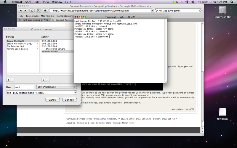

I'm not very familiar with the whole Terminal thing, but I am handy with Google. However, when I try to create an SSH connection to my iPhone to enable saving, it gets to where it asks me for a password, but won't let me type anything. I've included a screenshot to show what it looks like.
Lawls! It's just like the old computer login script on my teacher's computer some 12 years ago. You just can't see it type!
God, this was such a terrible question that I couldn't find on google.
I promise I'm way smarter than I let on.
And thanks! I don't understand the command enough to get what the problem was, but it sure did fix it.
(Why can't it be BASIC or Window DOS commands?)
