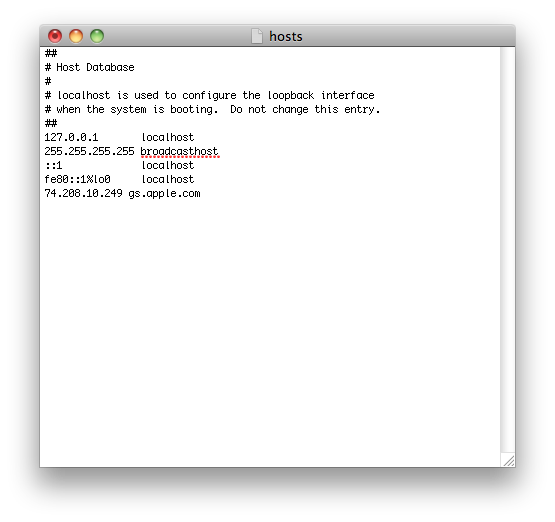

Yeah. Edit your host files. This seems to be causing the issue with Apple's server.
The host file should be directed to the Cydia server. Screen shot below:
Same old recovery screen. I have windows 7, would that have to do with anything at all?
