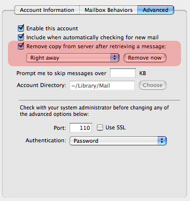

Everything seems to be typed correctly. It receives, so I not sure why it won't send. Also, I notice that email received does not pull it from the server like my home computer. Why is this??

It's probably not deleting messages from the server as you download them due to a setting in Mail. In the Advanced sub-pane under the account in question, there's a check box to enable deletion from the server with a menu to specify when the deletion should happen.

Also...mail is now off the server as I retrieve it!!
