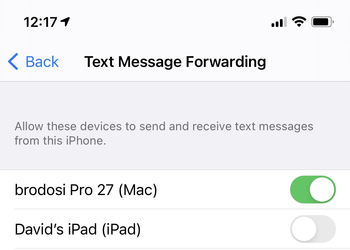

On your iPhone, go into the messages settings and look under Text Message Forwarding. Make sure your computer is selected.

For a test, I sent an SMS to a friend with an android phone from my computer. He received the message without issue. I then turned off forwarding to my computer and the SMS would not go through nor could I received SMS from him. Turned back on forwarding and re-selected my computer name and everything was working again. I have this setup on my home computer, but not on my laptop as I use it for presentations, etc and don't want messages going off during a training. Please keep us posted. Cheers, David Brodosi
