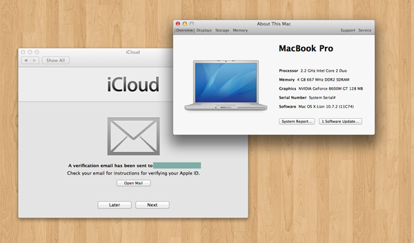

I checked my system serial and its got
Serial Number System Serial#
I havent had my board replaced and my serial was there before this lion 10.7.2.
After the update this happened😡

Yeah, it's because of the unset serial number. The serial is sent as 'fffffff', which of course has registered a heap of iCloud accounts, and has been blocked by Apples systems.
Issue is, if they allow the blank serial to register accounts, it's just inviting bots to make fake accounts.
ED2: Getting close, but no banana https://setup.icloud.com/setup/create_account_ui
ED3: For those comfortable with a debugging proxy, it's a simple manor of changing this value in the response of "https://setup.icloud.com/setup/create_account_ui" on line 41. There are no further server-side checks in place once the initial page has been executed.
