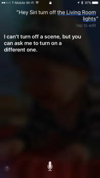

I made a scene called "Living Room Lights", which includes one Hue bulb, and one light plugged into a Kookgeek outlet. I can turn on the two things at once by touching the scene in the Home app, but Siri can't seem to turn them both on or off. What gives?
In the case of your screenshot, Siri explains the problem. You can't ask her to turn off a scene. Say I have a scene called "evening tv". I can turn it on by saying "set evening tv", or "turn on evening tv". But I can't turn it off by asking "turn off evening tv". You can only ask Siri to turn on some other scene (like "purple lights" or whatever). This example scene of mine happens to be in my living room. To turn it off, I can say "hey siri, turn off the living room lights" because these lights are set in the living room according to my HomeKit settings. Or you could say "turn off all the lights" to turn off all of your HomeKit lights (if that's what you want to do).
Are the two lights of yours set in the "default room"? Or are they assigned to a "living room"? If they are assigned to a living room, you should consider changing the name of the scene. HomeKit doesn't really jive when an item and room share the same name (I had this issue when I had an ecobee sensor named "living room" as well as a room called "living room". Siri would return an error when I asked for that sensor's temperature. It could have issues with scenes too because asking "turn on the living room lights" is a way of asking Siri to turn on all the lights assigned to your living room. It could get confused about turning on all your lights in your living room or activating that scene you named "living room"
  1. First Delete that scene you will not need it.
  2. Download the idevices app
  3. Launch the idevices app and go into settings and scroll down and tap on "Groups"
  4. Within the group select your devices you want to control
  5. Then name it "Living Room Lights" (this is NOT a scene)
  6. Now you can tell Siri to "Turn ON" or Turn Off" the "Living Room Lights"
While that undoubtedly works, you no longer need to use a third party app to group things. The Home app has it built-in now. Just long press on one of the lights, and then you should see anoption named "Group with other Accessories". Once you choose that, you can name the group and choose the other lights.
To clarify what seems to happen with the the above steps (and I haven't done this very often, so it could be wrong, I admit) - when you group accessories together using the Home app and name it (e.g., "Living Room Lights"), the Home app automatically creates two scenes (e.g., "Living Room Lights On" and "Living Room Lights Off") with the selected accessories. Then Siri will be able to turn those accessories on or off with one command.
Scenes are only activated whether it be function of turning things on OR off. Ignore how it works in the app.
For example my "Good Morning" scene turns ON my bathroom, kitchen and bedroom lights. So I can't say "turn off Good Morning" because good morning turns ON things.
So if you said "Hey Siri living room lights" it should activate the scene you made. If you say it again, nothing will change because its an on function.
You could make another scene that turns off the living room likes but that is getting a little silly.
You want to group your living room lights and call the group living room lights. That way when you say "Turn on living room lights" all the devices act as one device. Call individual items something else like living room lamp, living room reading lamp, living room ceiling light, etc etc. That way if you wanted to bring on an individual light you can still do so.
Not in my experience. I have a couple of groups and there is no scene. It's just that now the group shows up instead of the two or three lights individually.
Reactions: BrettStah
