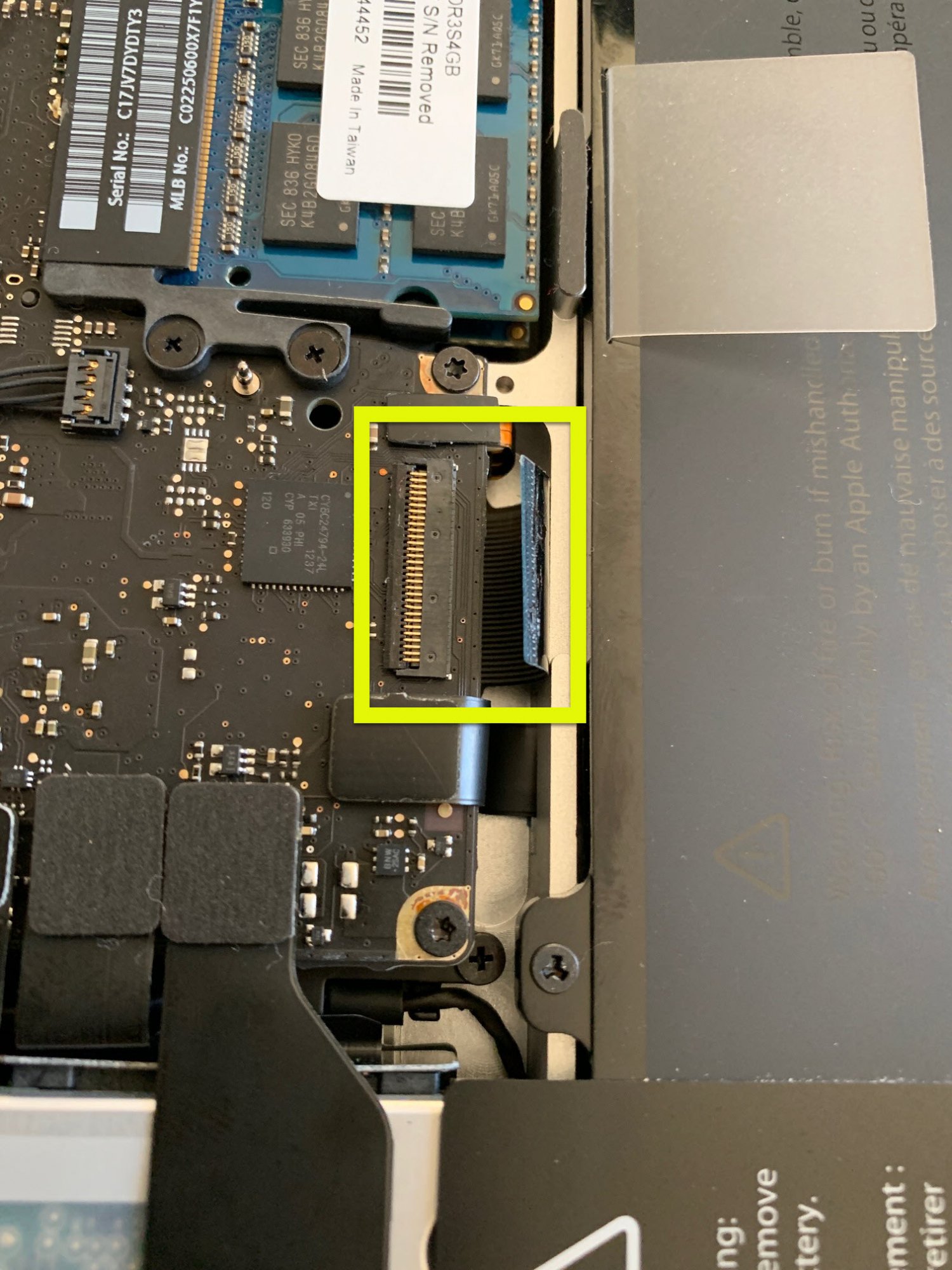

The last few times I tried to start the computer, it will not start regardless of which RAM (old or new).
I opened the back and found this. Pushed it in, it started. It started three times I powered it up.
Now, I removed this ribbon to make it sit in good enough but I can't get this ribbon to line up inside enough. If I can get it to line up in enough, I would just put a small strong duct tape on the ribbon an on the female receptacle to hold the ribbon in well. Or, I can melt a glue stick over where the ribbon enters the receptor. This ribbon is very delicate.
Can this ribbon be replaced without taking it to Apple Store?
This ribbon does not seem to have a visible wire (pin) at the end, but it works when well inserted.
What should I do?

Are you sure you have a 2012 MBP 15 unibody?
That looks like the keyboard cable connector on a 2012 MBP 13, not 15
Your logic board looks like a MBP 2012 13" not a 15" which has the connector underneath a metal cage
If you're having problems figuring the connector out, STOP right now and bring in to a professional who can handle it. It takes a very light touch to connect ribbon cable like that and you can easily destroy your computer by breaking the cable or worse, the connector on the logic board.
If you're still willing to try to do it yourself, see this guide and fast forward to step 11
My other concern is how the heck did that cable come out anyway? Was your macbook repaired previously?
