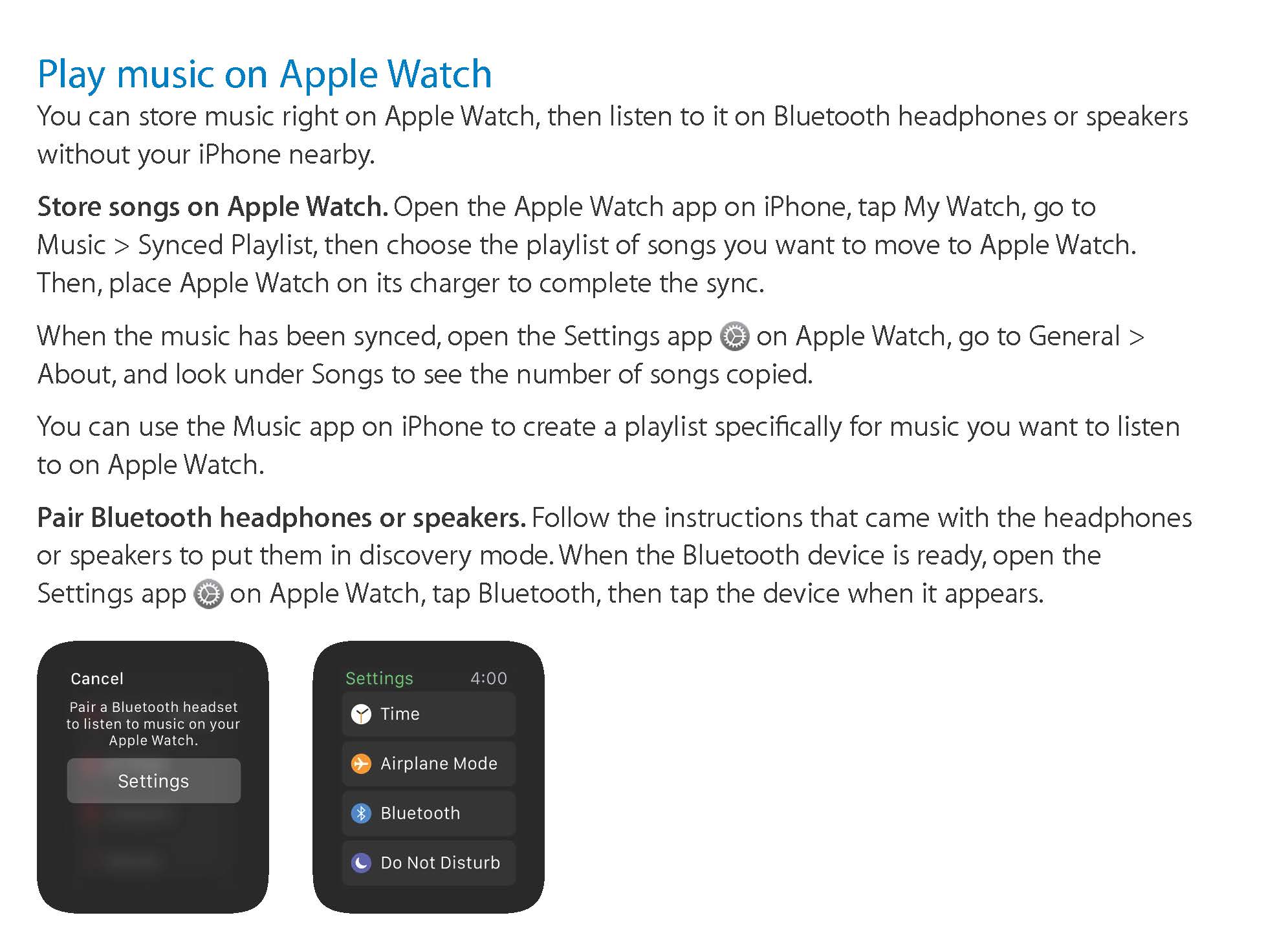

The watch must be charging.
Well that's not the case really. Because I can sync any other playlist without a problem. Just this one. :-(
And I'm not sure where you are getting that from because I don't see it in the graphic you posted. Is there somewhere else I should look?

I see it now. My bad. But it still doesn't make sense because very other playlist syncs.

I was also momentarily confused by this when I tried syncing but sure enough it worked when I plugged the watch in.
