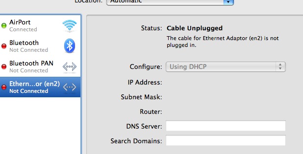

It should appear after you have plugged in the iphone via USB and turned on Tethering on your iphone under Settings->General->Network and you should then go to your network settings on your mac and should see an entry called Ethernet 2 or something like that.
Your Network should look like this and it should say Cable is Connected. To get VM back. You need to Option-click "Check for update" in iTunes with phone plugged it and navigate to User/Library/itunes/iphone support carrier and click Open. It will restore the original carrier file and remove Network Data selection from your iPhone. Now both will play nicely together. I had mine working since 3.0 came out.

When I plug my iphone in, I don't get an option for ethernet 2 or anything. Just unplugged ethernet port and airport. Could this have something to do with the fact that I enabled tethering before officially being told I could by Fido? I went to a site and got it enabled there via a small installation. If so, can I get rid of that, and get it from Fido?
