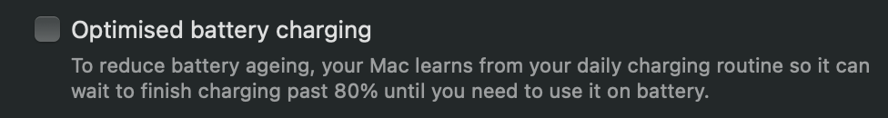

True, but turning off Optimised Battery Charging on an M1 Mac should stop the 80% hold behaviour:

No. My screenshot of the Optimised Battery Charging Setting in pref pane is quite clear that that is controlling the 80% hold behaviour. If what you are implying were correct all M1 MacBooks would always be subject to the 80% behaviour with no control, which is not the case.

To clarify what I wrote above, I agree that BHM, which cannot be turned off in Silicon Macs, can sometimes reduce the maximum charge, but this is not the same as the routine hold at c80% which is overridden by the "charge to full now" option which the OP is complaining about.
