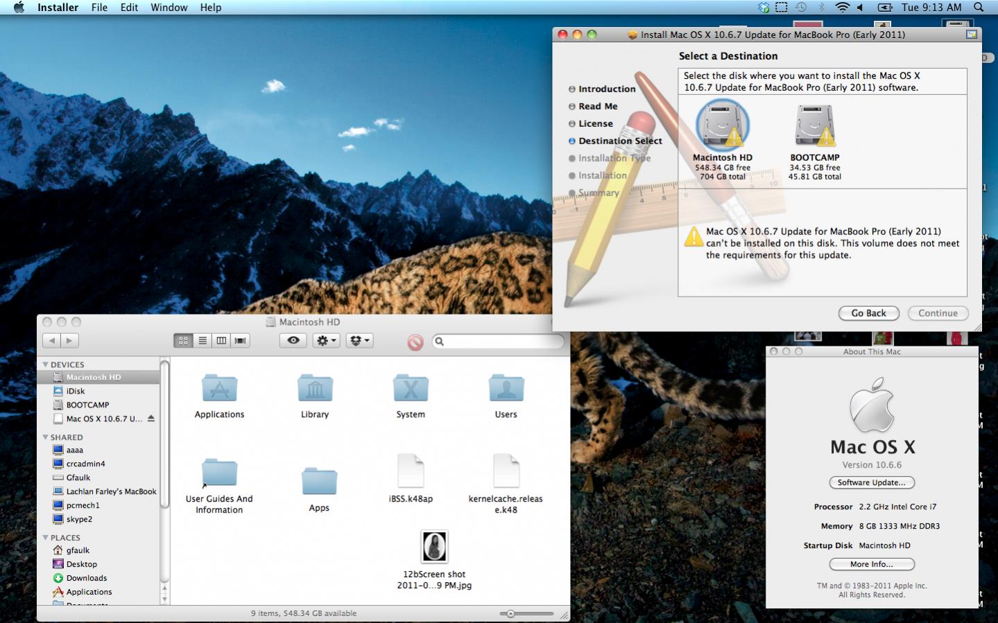

I have a new 2011 MacBook Pro.. I downloaded Mac OS X 10.6.7 special build for early 2011 MacBook Pros.. Which i know thats the one i got.. i have thunderbolt etc...
Well Software update keeps saying that their no updates for my system... So i went to apple.com and downloaded it and tried to install it.. This is what it says..
Any ideas?

Looks like your 10.6.6 should be at least Build 10J3210 for the installer to run.
The model needs to be 'MacBookPro8,1' , 'MacBookPro8,2' or 'MacBookPro8,3' which if you have Thunderbolt (as you say you do), it should be.
Other than that, there doesn't seem to be much else that should be preventing an install.
After successfully applying the update, the build should be 10J3250.
Well I'm on 10.6.6.. And whatever build came with my Mac..

Apple called me back around 1 EST..
As stated above the build number on my mac is wrong.. Updating it to the correct build from the CD and then going to try to install the update...
I dont know how this could have happened.. I didnt restore from a time machine or anything like that.. Hopefully this works

I have the EXACT problem..
Bought a new macbook pro today, model 8.2
I had the factory 750 gig HD replaced by a 500 gig 7200 rpm HD at the store.
i have build Mac OS X 10.6.6 (10J4026) that came on that 500 gig drive.
Trying to update (via software update) or by trying to install the 10.6.7 combo update : both methods a no-go 🙁

The problem was that when i restored my macbook from my time machine.. It put the old os back on. And when .7 came out my computer wasnt built with that build that time machine put on so it wouldnt let me update. i basically had to restore computer...and start all over... You could how ever put in your mac os disc.. and do new install and have it save your home folder. that should put the right build back on your computer and allow you to update..
Thanx for the response mate.
I succesfully upgraded to 10.6.7 by indeed using the factory grey restore dvd that came with my macbook.
It just upgraded all the system files to 10.6.7 and let everything what i had installed (apps, documents, preference settings) alone.
I always thought such a restore would wipe everything :0)
