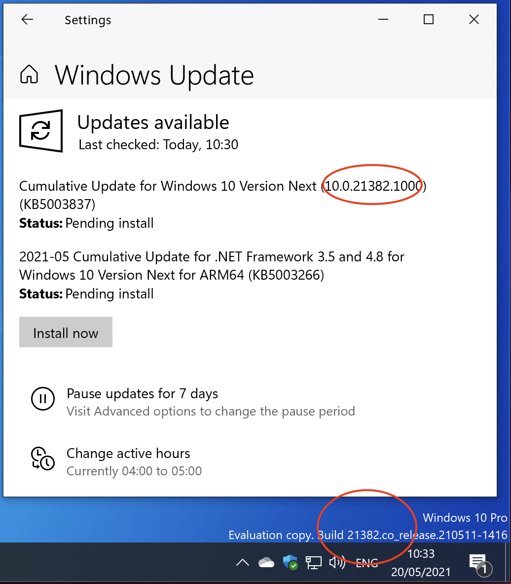

FWIW, Build 21382 has installed normally here.
BUT I have just seen that although it is showing 21382 (which I installed yesterday) in the bottom right it is still offering 21382 in the Windows update. Will see what happens!
I went ahead with Install now and it has "reinstalled" 21382 without any messages like yours. This was too quick to be a full update and todays update does not appear in Update History, only the original 21382. Don't know what happened. Windows Update is not offering anything more.
For anyone with the same problem, disable shared folders in Parallels and Windows will update perfectly.
Also the screenshot shows a cumulative update, not a newer version system update. (They were 2 one after the other).
