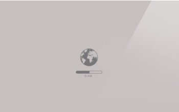

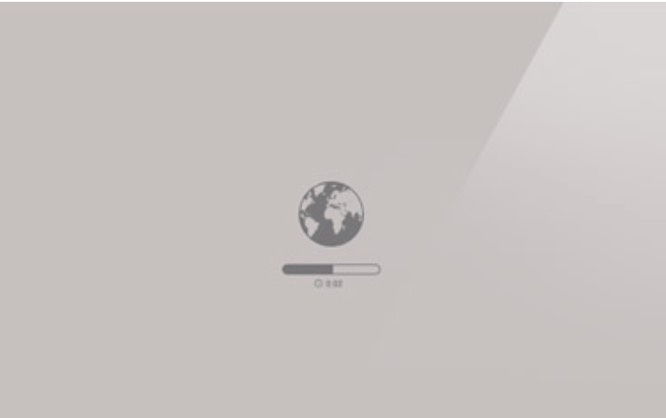

Do you also see a picture of a globe when starting up similar to this?:
If yes, then it would indicate it is starting to Internet Recovery.
The OPs 2009 MBPro is not capable of booting to internet recovery. Hardware is too old.
