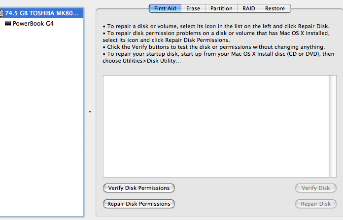

My HD is making alot of noises and Apple "doesn't see a problem", so I just went to verify the disk anyway to see what came up and it won't even let me verify the disk?

you need to boot from the install cd then run disk utility from there, or use an external HD with Mac installed. resoning for this is that the hard drive cant fix itself (or something like that), all you can do is verify/repair permissions.
Even to verify? I've always been able to verify the disk from disk utility without booting from the CD.
Yeah... that's what I thought. Could that be a sign of the HD failing? As much of a pain as that is, I'd rather it happen sooner than later.
Possibly. I'd try verifying (and maybe repairing) from the OSX discs all the same though.
is that feature new in 10.4? cuz i have 10.3.9 and i cant do that
EDIT: ok i can verify disk on iMac G5 running tiger, but it says to insert disk if i want to repair
Yeah, Tiger allows you to verify the disk but not repair it and yes it's a new feature. 🙂
Gracias to madjew and xsedrinam. I'll boot from the disks in the morning and do my whole backing-shizzit-up thing, as well.
Booted from the CD's, and did repair for the disk and permissions. It said the disk was fine, and did some garbledook for permissions like normal. I still can't verify the disk, and it's still making the same sounds.
