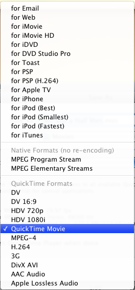

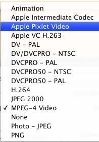

I've used my Hybrid (original with 2.5.3 of the EyeTV software) a few of times for exporting TV content recorded over analog cable and 1080i HD over the air. It does a decent job. I'm not a professional editor so have no pro experience to compare it to.
Attached are the codecs I can export to. The second image is via the 'QuickTime' export option seen the the first image.

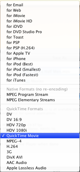

You want to export to DV if it is SD footage or HDV if it is HD footage assuming you want to edit the footage in a video editing application.
