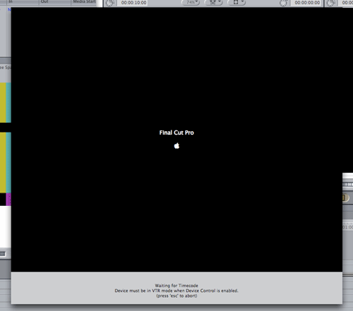

I'm totally newbie in FCP, sorry for the stupid questions. But this is the screen I get when click Capture Now:
Try disabling device control. I think FCP is trying to control the device hence the need for VTR mode. I can't remember where it is in the settings (i'm not at my main computer at the moment) but I believe it is in the capture settings area.
Bit of a stab in the dark there as I have not done any direct capturing myself.

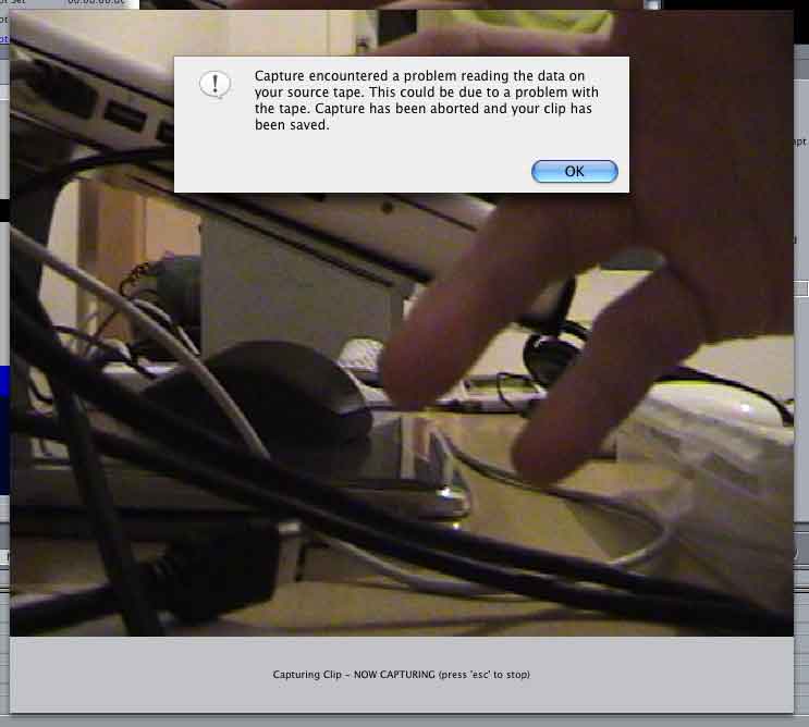

Thanks Cromulent ! I've disabled device control and it just worked fine. But now I have a new problem. I get an error message talking about tapes ! Oh Lord, how could that be so simple in iMovie and so tricky in FCP ? 🙂 (I'm just joking, I know FCP is professional software and bla bla...)

Problem solved guys ! I guess the problem was the wrong capture preset or something like that. I'm using a NTSC camera and the preset was to PAL.
