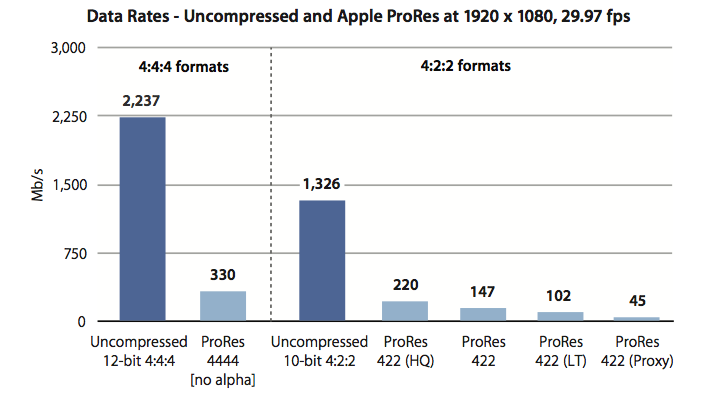

What ProRes setting did you use?
Because ProRes might be overkill for HDV footage, AIC (Apple Intermediate Codec) is more than sufficient for that.
Whatever ProRes setting you used could cause high data rates, which USB does not offer consistently for video capture. USB will get 35MB/s in burts, 25 to 30 MB/s is more likely.
numbers in Mbit/s, to get MB/s divide with 8, 100Mb = 12.5MB
from Apple ProRes White Paper July 2009
