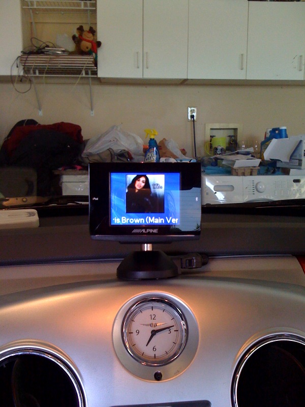

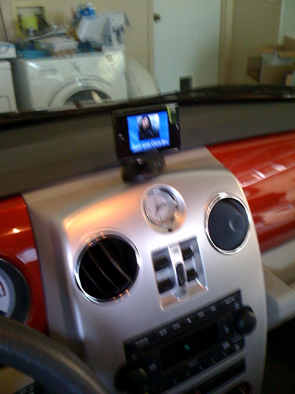

can you post some real pics of how it looks like in your car all set up
The brain is hidden behind the glove box and all wires, except for the cigarette lighter adapter and the high speed cable are hidden in the dash. Install took less than an hour.
I'm going to be putting in an additional cigarette lighter adapter behind the dash for it as well.
Only took two pictures when I installed it, but here it is on the dash of an '07 PT Cruiser (wife's car).
