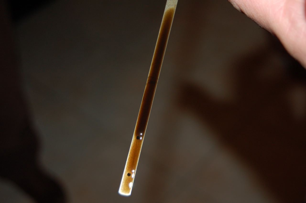

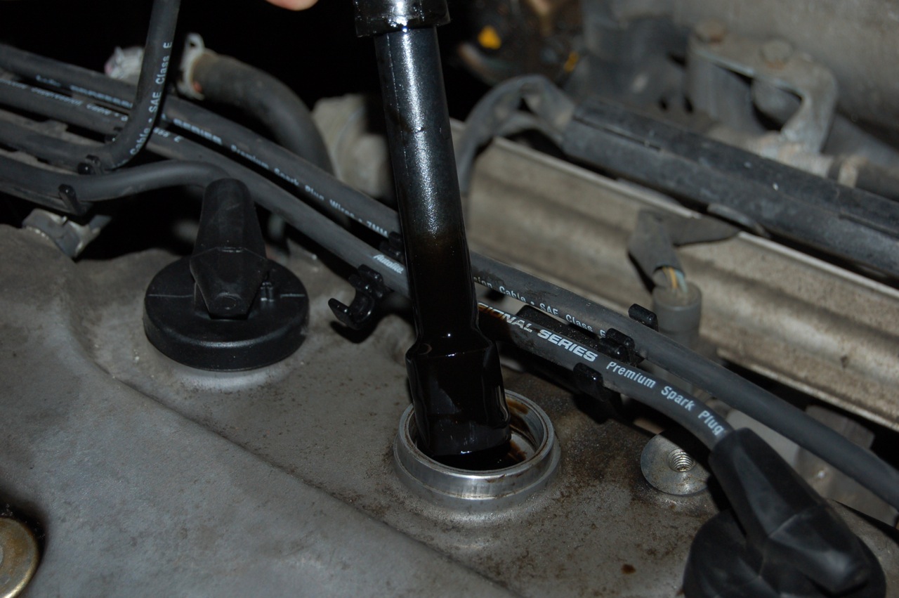

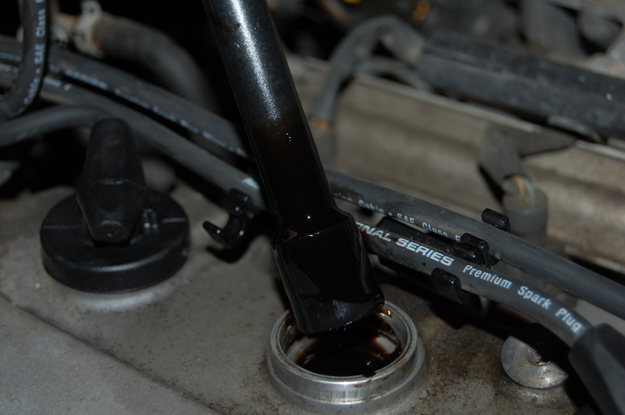

Alright, I'm not sure that milky oil looks like, so I'm posting some pics.
One is of the dipstick with oil on it. Yes, I know there's too much.
The other 2 are of the second ignition coil. There's not supposed to be oil there, right?

Can anyone take a look at the pictures and tell me if the oil looks milky, or like it has antifreeze in it?
Your oil looks good. Is it oil or just grease on your ignition wires? If there is a lot of oil on them you need a new valve cover gasket. It's cheap and east to replace.
