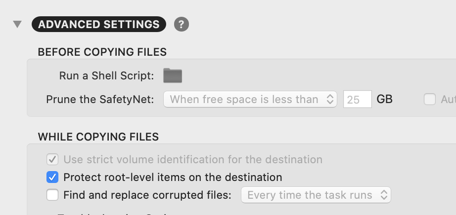

If I understand your question correctly, you have a backup disk to which you use CCC to backup your machine. On the same backup disk, you would like to store private files that are not backed up as part of the CCC plan. You want the private files and the CCC backup to co-exist, one not harming the other.
If that is correct, then you need to enable the setting "Protect root-level items on the destination". That setting is located under Advanced Settings, for your backup job.
By enabling that, CCC will clone your machine to your destination disk, but if there are other folders on the destination that are not part of the CCC backup, they will not be affected.

Safetynet and protect root-level items are independent of each other.
Safetynet is a means to keeps copies of files that change within the backup plan, through each run. Whereas protect root-level items, keeps files on the destination that are not within the plan safe.
An example how I use protect root-level items. I have a 2015 MBP. I use a CCC plan to backup the contents of its internal SSD to an external drive. I also have a 512 GB SD card, and I manually copy some of its contents to the same external disk. For that I create one folder on the external disk called _Protected. The name does not matter, that’s just what I call it.
My folder is safe as long as the setting protect root-level items is on. If that setting is turned off, CCC will delete my folder the next time the plan runs.

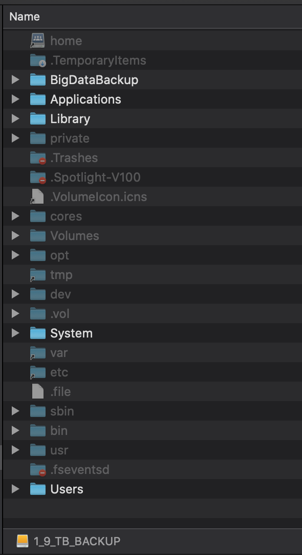

Yeah so whatever data is (not) part of the data being cloned, is safe as long as the Protect Root-level Items option is checked. Does the non-related data need to be in its own folder? Mine is in its own folder, but I'm just curious.
The BigDataBackup folder is my manually added stuff. The other files are from CCC. That's ok? And with CCC we don't need to actually select that folder like TimeMachine asks you to do since CCC already knows to leave it alone.

If your Mac is running Big Sur, yes. As of macOS Big Sur, we're required to use Apple's APFS replicator to establish a bootable clone of an APFS volume group. We're unable to leverage the SafetyNet feature, and it's no longer appropriate to store other data on the backup volume. You must dedicate a volume to your bootable backup. Once your bootable backup is established, CCC will use its own file copier to update the destination Data volume in subsequent backup tasks.
I want my clone to be bootable therefore with Big Sur we can no longer have extraneous data on the same drive.
That's easy because with Disk Utility and APFS you can split your HD without partitioning. The volume sizes get adjusted as needed on the fly. So I have a "CCC Backup" volume and a "Other Data" volume. Whatever amount CCC needs its volume will use that and the other volume can use what's left. Very nice!
You can have a clean CCC clone (no Safetynet) on one volume and set up a second, non-bootable CCC clone, folder to folder if you like, on another volume for selected data folders. In this way, you can maintain historical backups of your files without Safetynet throwing a bunch of system stuff in the Safetynet folder.

Yes, that is correct. Any file or folder not part of the CCC backup is safe. I also just put my extra files in a single folder, it seems more organized and identifiable that way.
