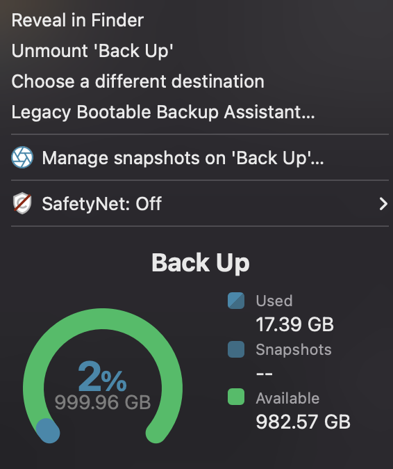

Hello! Sadly since updating to Monterey 12.6.4 with the Mac Pro 5,1 it's impossible for me to get a bootable clone of my boot disk. Neither CCC nor SuperDuper are working. Latest versions in both cases.
I keep getting "Volume replication failed" (49197) errors.
Can this be caused by any of the OpenCore-settings or any other suggestions? Worked with both of the apps before.

Nope. Using OpenCore and i have perfect bootables clones.
If you report this with logs to the CCC developer he can tell tell you what is causing the problem With legacy bootable snapshot Copy. But yes the Apple APFS utility needs to conduct a 4 pass copy of volumes then it needs to have enough time to unmount, name the the volume and see that you chosen not go away in the end by so many seconds and be mounted when this method is completed.
So i found out a little more inbetween: CCC is able to create a perfect bootable copy of my usual startup-disk, when booted from some other drive! Even if this drive is running 12.6.4. But, whenever booted from the drive itself, it refuses to replicate the AFPS-structure with the mentioned error. Even when logged in as root instead of the normal user.
Somehow strange that is!
You need to prepare the volume for APFS replication to work. 11.x and the new 12.0 creates both a system and data volumes. Erase both in the disk utility -> unmount backup target storage, erase system volume not the data volume, select erase volume group as preparation. In CCC you need to target that one volume as a destination in CCC with a new task. Then you will need to use the CCC choices in under your destination.
click on the destination disk you will see this.
Enter the legacy bootable backup assistant. I don't use SafetyNet for incremental backups, so that is off. Allow CCC to erase the volume.
Now when you start CCC backup task it should tell you that you are Replicating the APFS filesystem data. After it gets done this in disk utility should show both a system volume and a data volume. Now see if it will allow you boot off of it.
I've been trying to use other software to clone my Monterey external SSD to the old iMac Fusion Drive as a backup since I'm using the external SSD as the boot drive. Because of the post-Catalina double volume thingy, I've not had any success. This post finally did it with CCC. Thanks!
Hmmm, in my case, it seems to be more of a source- than a target-issue. As mentioned before, i can get a bootable clone of my main drive with CCC's Legacy Bootable Backup Assistant without any hassles, when booted from some other drive. But, when booted from the drive to backup itself: No dice!
At least for me, the different partitions of the destination, also allready beeing a bootable Monterey-drive, don't show up as different volumes in the target pulldovn in CCC.
