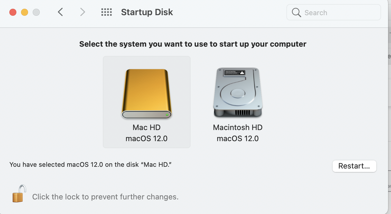

beta 4 Monterey introduced some new authorization permission changes, such trying to boot from a CCC clone startup disc in preferences is buggy. Do that from recovery mode more options is safer. Also some people observed beta 4 requesting authorization for Rosetta before it’s used with a Intel application.
^^^^Not all startup disks showing in "Startup Disk" is not new to Beta 4, it's been happening for some time, including Big Sur. I just checked my system, and all five were shown. The remedy is to restart and hold the "option key" - all disks will appear in "Startup Manager".
Lou
Lou
I had no issues selecting startup disk in Monterey beta 4, after you selected the disc it now challenged you to authorize the account to use for boot up in start up preferences.
Then what's different is it went through the boot cycle and got to the half way progress point of the security accepting the external drive it halted or crashed and rebooted with that occurring indefinitely.
If you instead boot from recovery mode elect which disk to boot from it didn't fail in the same manner. From earlier beta 3 post: "The system asked for my password towards the end of booting."
I thought things might be different with the beta 4 change below, never easy it seems. Bugs!
Yes when this bugged boot was going on, I could not interrupt its loop, could not get into recovery mode until I forced off with power and for good measure unplugged the power to the iMac for 30 secs. 🙂
macOS Recovery​
Resolved in macOS Monterey 12 beta 4​
  • You can now start up from macOS Recovery. (78334511)
Oh yeah feedback to Apple of course.
^^^^Hmm, I had no such issue. I just made a clone of my startup disk to my backup disk - Monterey B4. Booted from my backup disk and booted fine👍 I have never had a request for my password.
BTW, all five bootable disks did appear in "Startup Disk".

Yes, you CAN boot from external hd on M1 MBA running Mac OS 12.0 Beta. I know because I'm using that MBA right now booted from the external drive.
Reactions: mikzn
MacOS 12 Beta 6 shows Apple finally remediated some issues, because the wipe and make a new CCC backup using APFS replication was finally bootable without crashing, although it went thorough more then one reboot for it boot to the main Monterey logon screen.
The earlier betas before beta 6 had some issue with it almost booting then crashing on my M1 24" iMac. What I was doing was testing out the CCC APFS Replicator using 6.0.3 b2 to see if it made a bootable copy to a USB-A connected HDD.
There were some odd issues we first saw in b4 and b5 with asking for your admin password after the OS install had downloaded, and prepared just before it reboots appeared to work a lot better with b6.

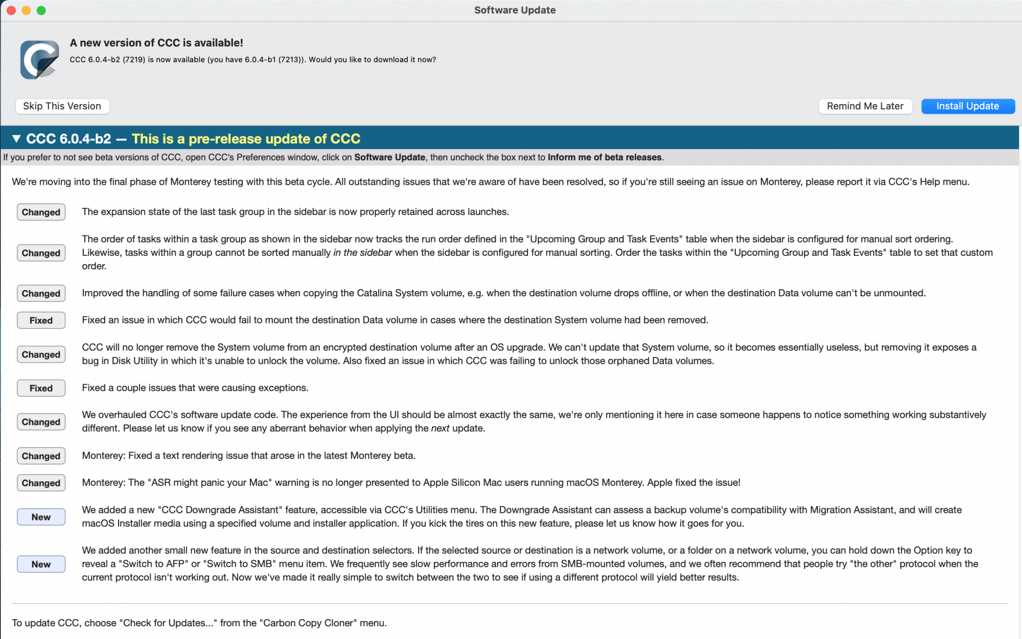

CCC 6.04-b1 is now available if beta downloads is enabled
We're moving into the final phase of Monterey testing with this beta cycle. All outstanding issues that we're aware of have been resolved, so if you're still seeing an issue on Monterey, please report it via CCC's Help menu.
  • New
    We added a new "CCC Downgrade Assistant" feature, accessible via CCC's Utilities menu. The Downgrade Assistant can assess a backup volume's compatibility with Migration Assistant, and will create macOS Installer media using a specified volume and installer application. If you kick the tires on this new feature, please let us know how it goes for you.
  • New
    We added another small new feature in the source and destination selectors. If the selected source or destination is a network volume, or a folder on a network volume, you can hold down the Option key to reveal a "Switch to AFP" or "Switch to SMB" menu item. We frequently see slow performance and errors from SMB-mounted volumes, and we often recommend that people try "the other" protocol when the current protocol isn't working out. Now we've made it really simple to switch between the two to see if using a different protocol will yield better results.
