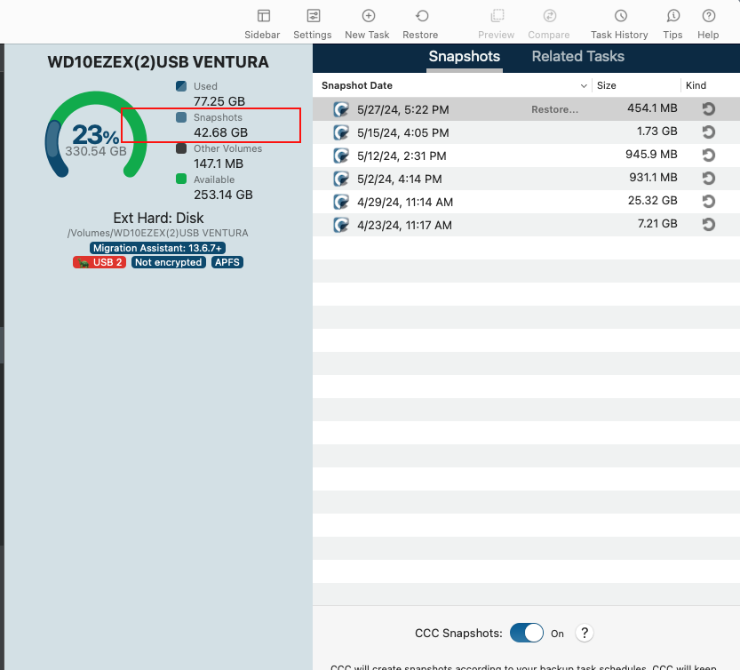

My Ventura backup is unaccountably ~15GB larger than the source, the data volume. I have always made certain that safety net is off, could snapshots account for this significant difference? If not that then what could explain this difference?

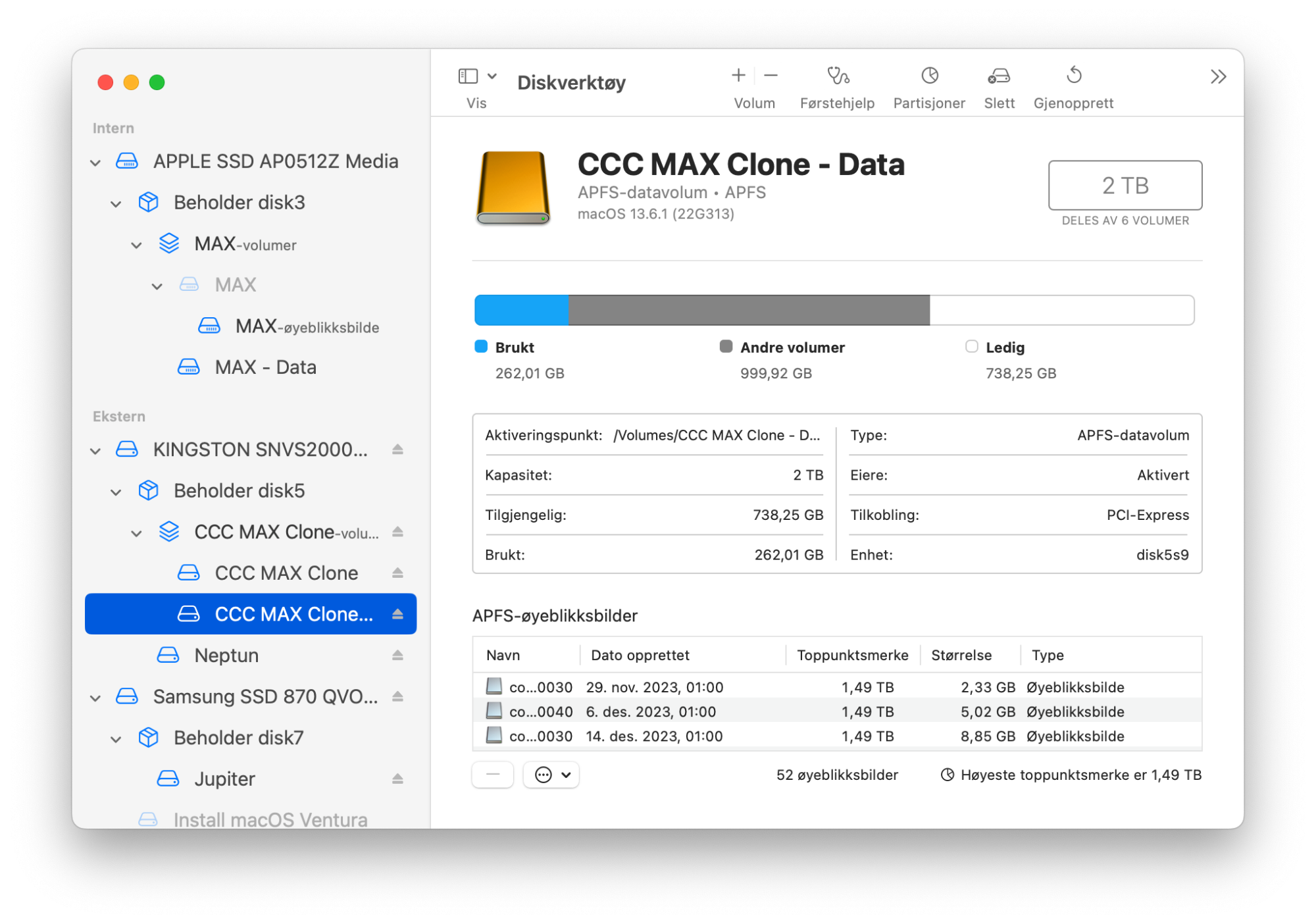

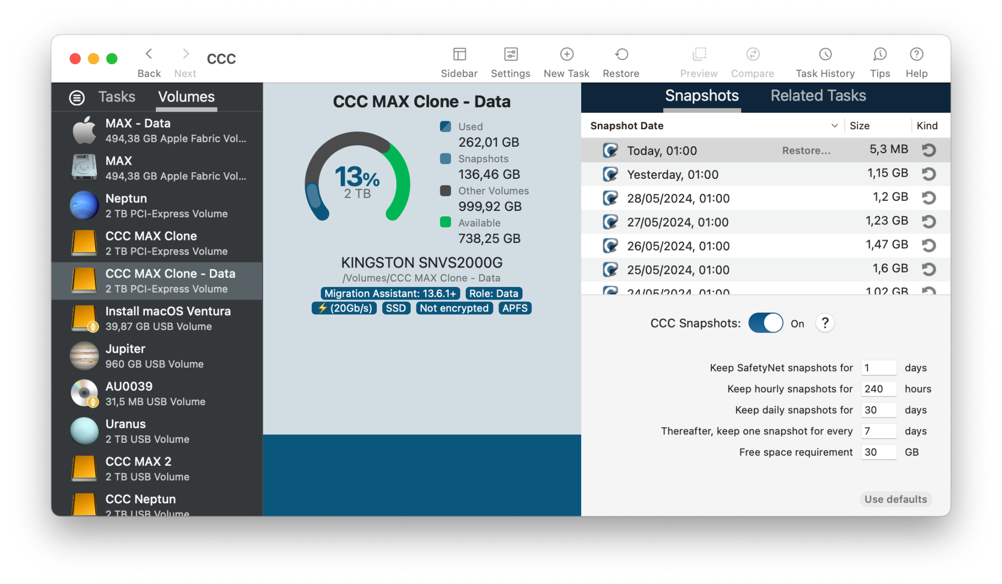

In CCC, volumes tab you can see how much space is used for snapshots, browse single snapshots and delete snapshots manually if you want. If you're using Timemachine, this is also possible in Disk Utilities, most of it.
Wow, thanks, much, much more than I thought. 42GB Insane! Time to delete all those accumulated and turn off snapshots!*
*Except might be interested in trying to restore from a snapshot a some point (however, according to Bombich, doesn't look good with a spinner, which I'm still using -- a bit afraid to open this iMac up to replace the HDD with SSD.)
