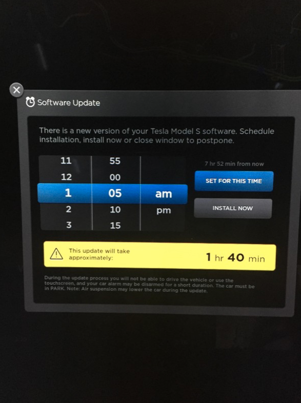

[rant]This is the one area that ALL car manufactures FAIL on except Tesla. When are they going to learn that modern cars need to be updated and it should be a seamless path.[/rant]
No updates are ever seamless. The issue is the way updates are done. Over the Air for your iPhone is relatively easy. Taking time off, leaving your car at the dealer's? That can be a PITA.
Then relatively easy (I meant [and said] "seamless PATH" as in the DELIVERY PATH/method of the update) like an iPhone or Tesla (which is auto downloaded to the car). OTA and just install vs trying to find out if there is an update, then contacting your dealer (who will have to research) to setup an appointment to drop off your car.
