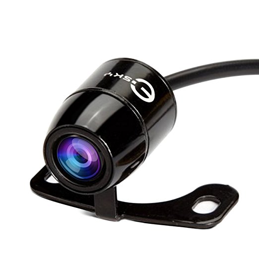

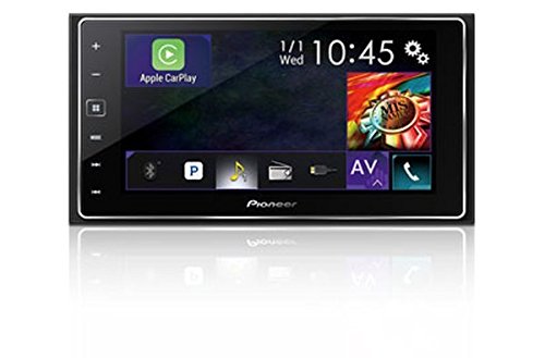

I bought this setup for my 2006 F150 and installed it myself. I no longer have the truck but CarPlay worked great and it sounded really good. I even had the factory premium sound w/sub in my truck. There were a few wiring kits I needed as well. Figured everything out on Crutchfield and then ordered on Amazon.
https://www.amazon.com/gp/product/B00O8B7CFS/ref=oh_aui_detailpage_o07_s00?ie=UTF8&psc=1
https://www.amazon.com/gp/product/B00GSFIJS6/ref=oh_aui_search_detailpage?ie=UTF8&psc=1

I ran the USB through the dash and out near the glove box. It just came through a gap in the panels. I can't remember but I think that unit had Bluetooth CarPlay...not positive though.
I tapped into reverse for the camera signal wire through the driver side door sill plate. I found the wire color on an F150 Forum. I believe I tapped into the reverse lights wire to power the rear camera. And the camera was just screwed into the bottom of my tow receiver bar.
The wiring harnesses will allow you to use your steering wheel controls and program them to whatever you want. Again, I figured those kits out on the Crutchfield site.
