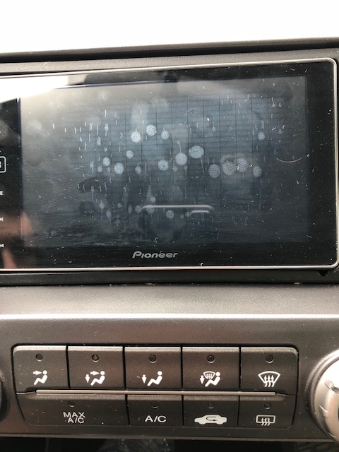

I bought a Pioneer head unit in January of 2016. Over time it has developed this fogginess/distortion under the display. I imagine I am well past the timeframe of when Pioneer would do anything about it, but was wondering if anyone knew if it was possible to remove the screen and clean it. I imagine its not likely possible, but I really don't want to spend more money on another unit. It looks okay at night, but on a sunny day it is almost impossible to see anything on the screen. Not sure it humidity in the summer caused it or what. It has never to the best of my knowledge gotten wet.
This picture is from October, it has gotten progressively worse since then.

I have the same unit and mine is two years old. It looks like it did on day 1. I put a matte film on it which helps with the glare, but it has no defects. Yours looks flawed. Then again, I live in Denver, where the humidity is usually in the teens.
Damn, was kind of hoping it was a widespread issue and maybe had lead to some kind of recall I didn't know about. Everything still works fine, its just this damn glare driving me nuts. I guess I'll contact them and see if they will do anything though I am doubtful.
You didn't mention what model, but it looks like an AR2 or AR4. Either way, it's not good news. Your screen looks like ones in these threads. Looks like the problem is the inner and outer screens delaminating. Only fix is to replace the screen which is expensive. Nobody reported having any luck with Pioneer doing anything about the failed screens.
http://avic411.com/index.php?/topic/39271-appradio-2-screen-issuerepair/&
http://appradioworld.17289.n7.nabble.com/AppRadio-4-Strange-marks-across-entire-screen-td1196.html
Reactions: bbednarz
Yeah, I ended up digging into it further that night and found the same thing. I contacted Pioneer just to see what they would say. They wanted $185 to fix it due to it being out of warranty, plus the potential for an additional charge if they deemed there was tampering involved. Figuring I really didn't have anything to lose I decided to take it apart to see if there was anything I could do to fix it and it appears not. Oh well, I'll just avoid Pioneer radios in the future. Looking at the Alpine with wireless CarPlay now.

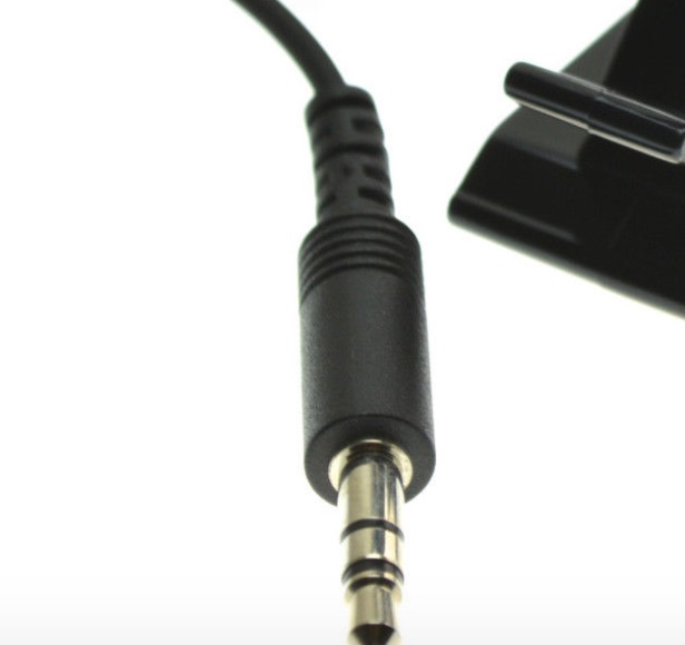

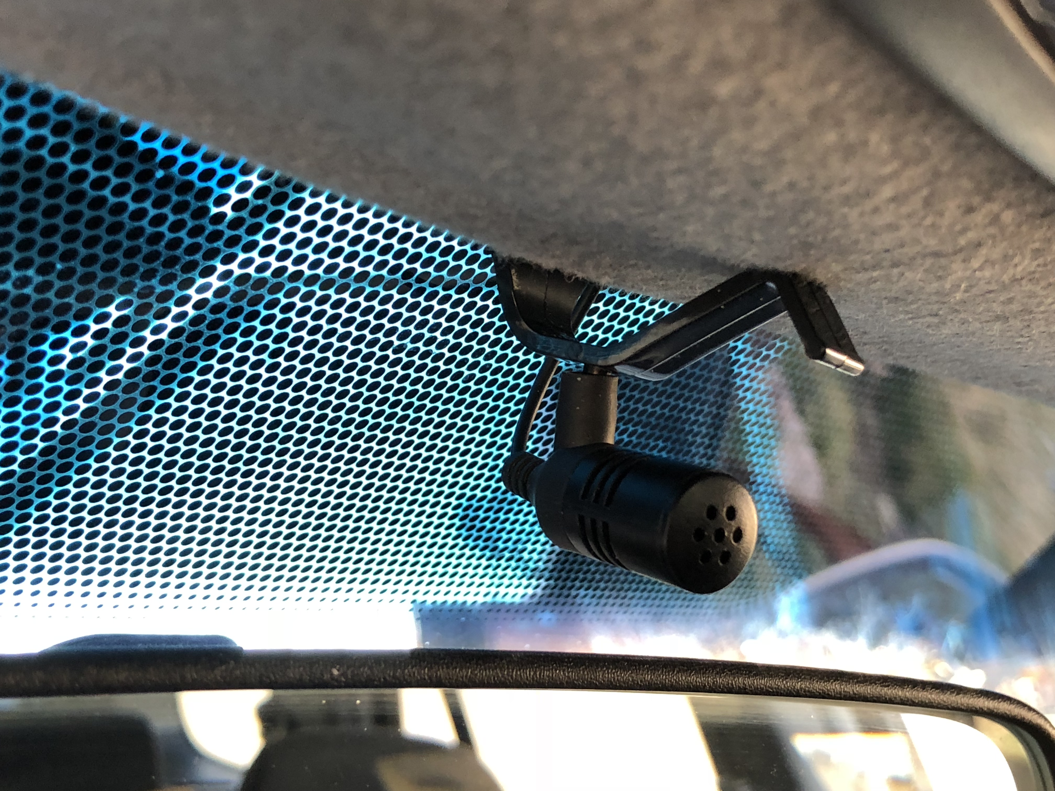

Might be the wrong mic. The one which comes with the iLX-107 is big and has a huge clip. I saw some Alpine mics on eBay which were smaller and looked like they had better mounting options. They were cheap so I bought one to try. It didn't work. I think the jack was different. Here's what the 107's looks like...
Edit: The mic jack for the iLX-107 looks like this...
