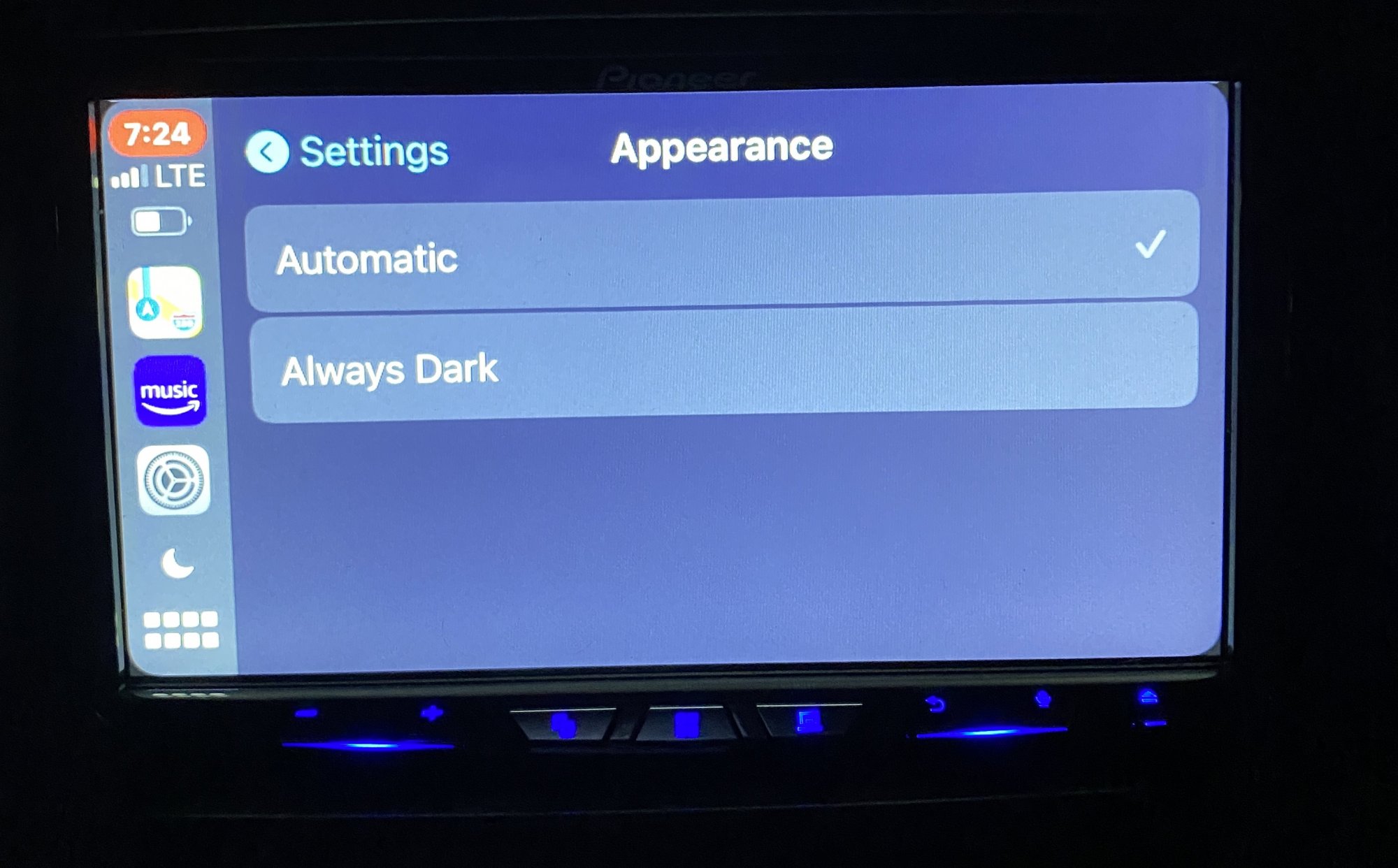

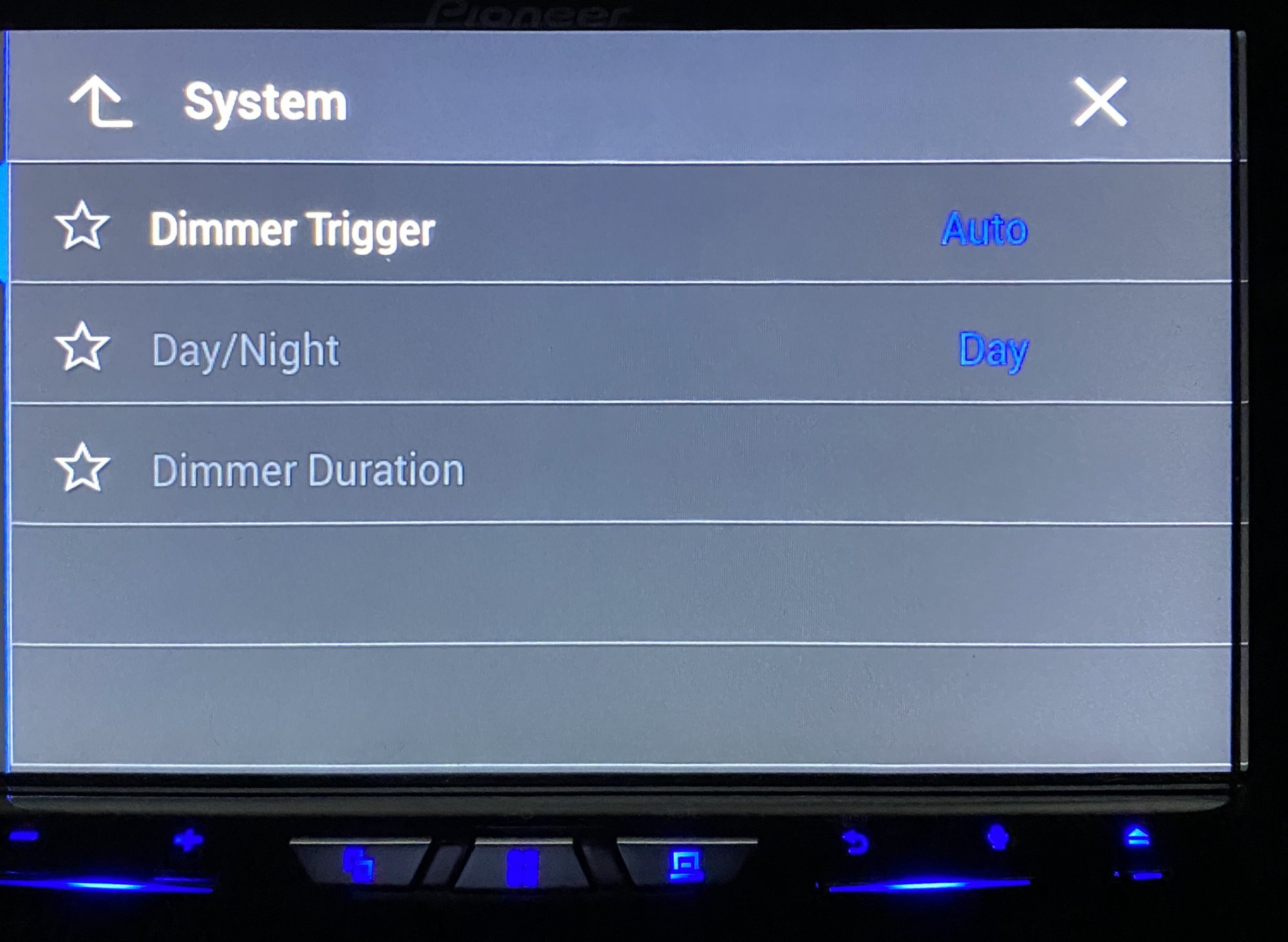

what are your settings on the 4500NEX? are you setting it to dark mode automatically on the 4500? or all the time? this setting don't seem to affect this bug i've encountered as dark mode does appear properly on the rest of the interface...just not Apple Maps.

I just checked the NEX settings, and the dimmer is set to automatic. The CarPlay settings are also set to automatic.
I wonder if yours is set that way in one place, but not the other?

following up: i am using the same setting as Ntombi -- dimmer on NEX set to Auto, and CarPlay dark mode set to Auto. i have tried two experiments in the last day (two dark scenarios):
