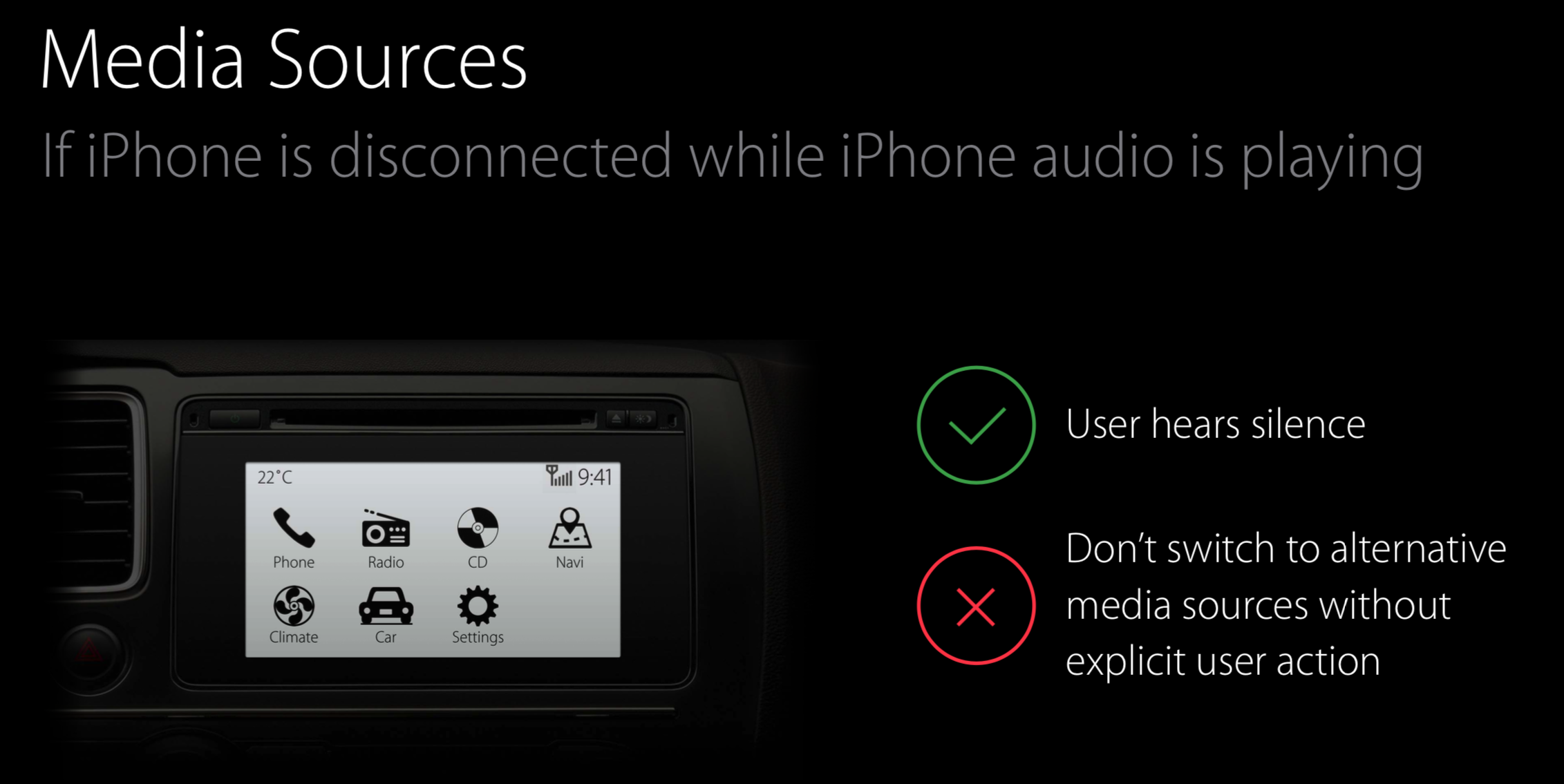

The minimum requirements for CarPlay integration is sometimes more than the auto manufacture wants to spend. For example wired input is LPCM. Output has to be 48khz 16 bit. You need a fairly high res screen, steering wheel controls, 25khz 16 bit input. etc. Plus there is programming required for the existing software, for example if CarPlay is disconnect audio has to stop, not go back to the auto manufacturers audio. Basically with CarPlay you are getting a reasonable decent head unit, input devices (controls and mic) at the bare minimum.
....Plus there is programming required for the existing software, for example if CarPlay is disconnect audio has to stop, not go back to the auto manufacturers audio....
When I disconnect my car's system starts playing in BT (same track). This is what I always use when not plugged in to CarPlay. Will switch it to FM and see what it doses.
This is just what is "supposed to happen". Apple can't control what actually happens.
Thats from WWDC16 though so a lot may have changed since then.
