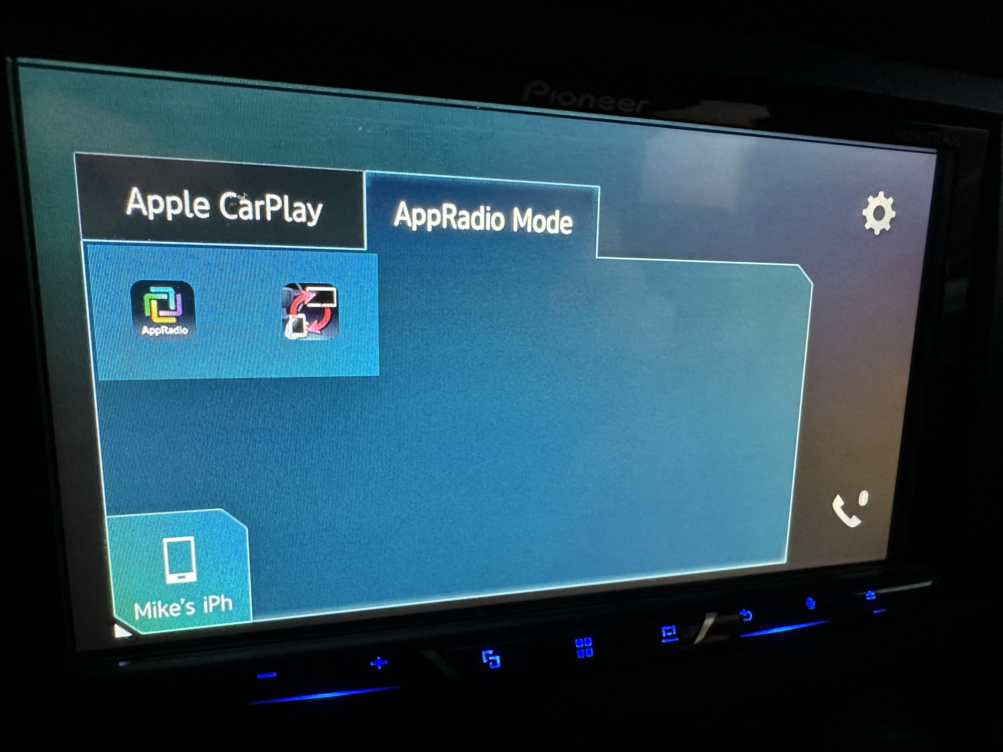

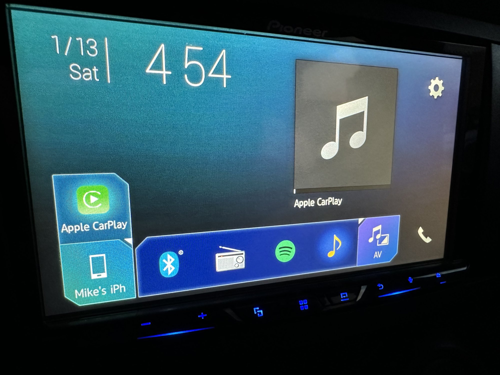

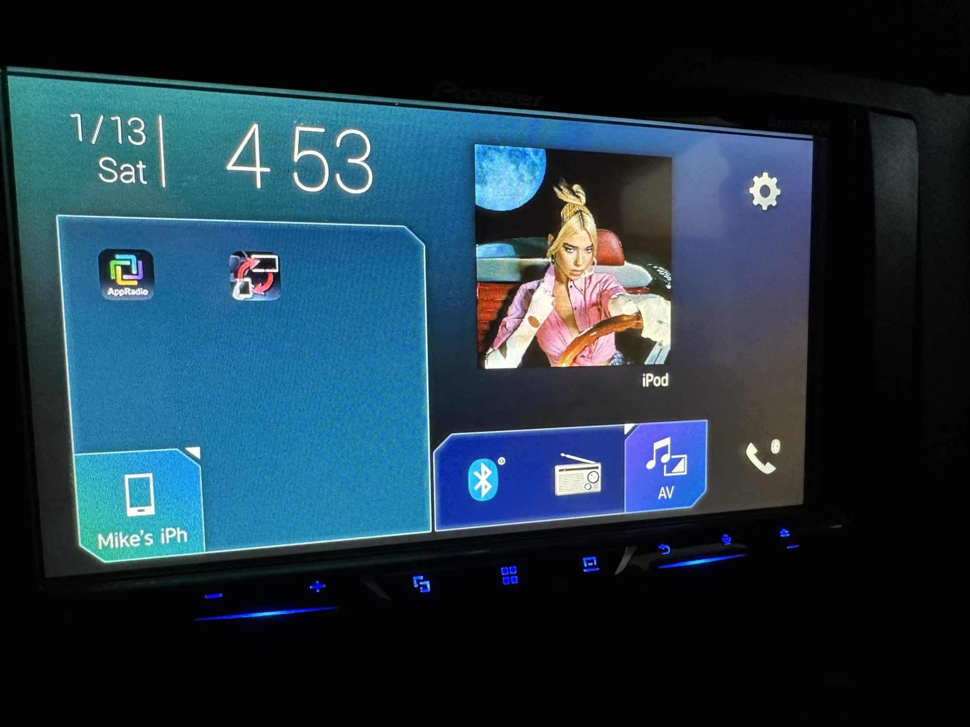

I found a solution that finally worked for me after trying everything else that was suggested. I am using a pioneer AVH – 2300 NEX deck. Tap the middle hardware button with the four squares. That will bring up the generic deck home screen. In the bottom, left-hand corner will be a smart phone icon Tap that and that will bring up two little icons one is app radio and there’s another one. If you tap the little window that those are inside of that will show you two tabs, the app radio tab and lo and behold, the Apple CarPlay tab. Hit that CarPlay tab and now a new icon appears over that smart phone icon, which is the Apple CarPlay icon. Tap at icon and Apple CarPlay works all of the sudden.
I swapped iPhone cables and power down the battery, and tried updates, both on the deck and the phone, and it was only messing with the deck itself that I was able to discover this. I hope this is the mystery solution that everybody else is looking for and if it’s not, I apologize, because I know how baffling this can be!
