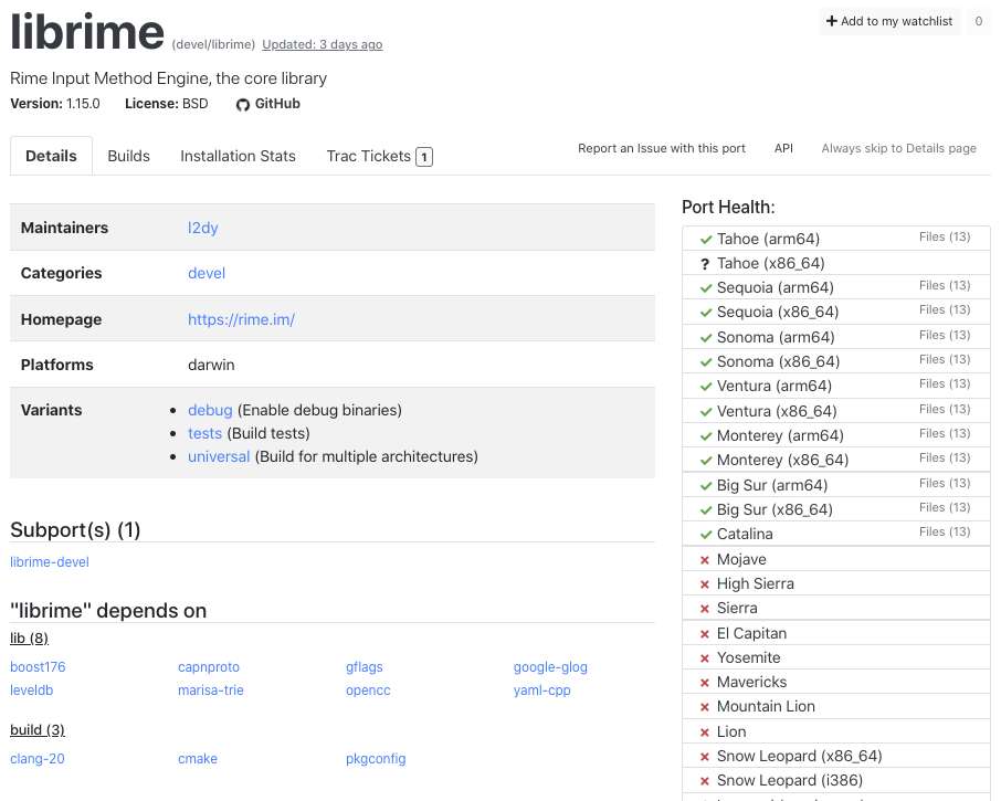

So few days ago MacPorts updates `librime` port. Details now show that it fails on all systems < 10.15:

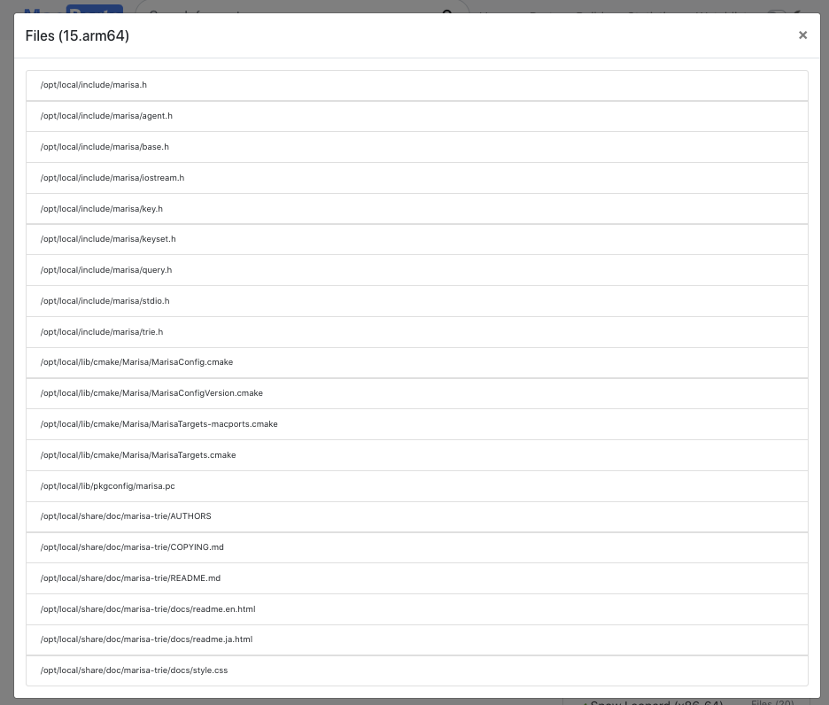

So I look if there is anything weird about my installation of `marisa-trie` (I used PPCPorts’ port, since MacPorts did not set correct C++ standard and build failed) and I broken it earlier with my fix. `port contents` shows there is no library installed, only headers, configs and binaries. That is not necessarily wrong on its own, since that’s how header-only libraries install, for example, and I did not know if `Marisa` is header-only at that point. But since CMake configure failed when looking for the library, I thought that library did not get built for some reason on PowerPC, and I failed to notice that. Fine, but then MacPorts also does not install any library:
So I look into the log of `librime` configure from buildbot on one of modern systems where the build succeeds. Turns out, it completely ignores `marisa-trie` port (which it should use), but instead picks marisa library from macOS SDK (which apparently was added in Catalina for god knows what reason):

Now it is clear how `librime` update could pass CI, despite the whole port being essentially broken. What is not clear is why MacPorts’ marisa is not used. I build `marisa-trie` from source to see what’s going on – lo and behold, the library is built, but for some reason is not being installed (same pattern on all modern macOS, example).

`librime` itself configures and installs normally once dependencies are sorted out. Notice, that Port health creates a totally misleading impression that `librime` update fails on older systems, and an attempt to `port install librime` (without -v flag) will probably just confirm that impression. In reality the port is broken on all systems, and the build incidentally succeeds on 10.15+ due to opportunistic usage of a wrong dependency, but there no issue with it actually specific for legacy macOS.
