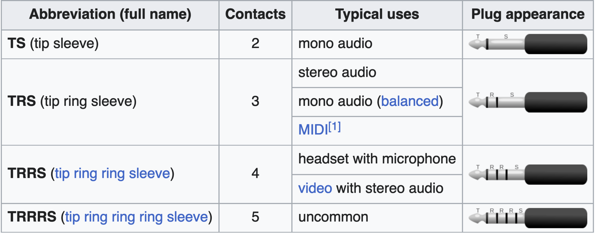

There are different types of 3.5 jacks. (google "trs vs trrs jacks")
trs carries a stereo signal, trrs carries a stereo and a mic signal. Sometimes the mic signal can also carry "control signals" (like pause/play, forward, reverse). The original cable airpods did that for example.
Depending on your type of 3.5 jack to USB adapter, the incoming music signal might be misinterpreted as a control signal for the "Music app".
To piggyback off of this, TRS and TRRS stand for "tip ring sleeve" and "tip ring ring sleeve." A 3.5mm jack is broken into segments, ranging from a single shaft segment for mono audio to multiple segments for stereo + microphone and/or controls.
You can tell what kind of cable you have by the number of rings (tip ring + shaft ring). If your USB-C to 3.5mm cable has 3 rings that means it's a TRRS cable and, as the previous poster said, could be relaying control signals to the Mac. You may need to return it and find a cable that's TRS only.
To be honest: My suspicion is, that he has the correct cable (TRS), but his adapter is built for a TRRS cable. So the sleeve of the TRS is triggering the second "R" of the TRRS input.
(If the adapter were built for TRS only, it would not relay ANY control signals to the Mac.)
