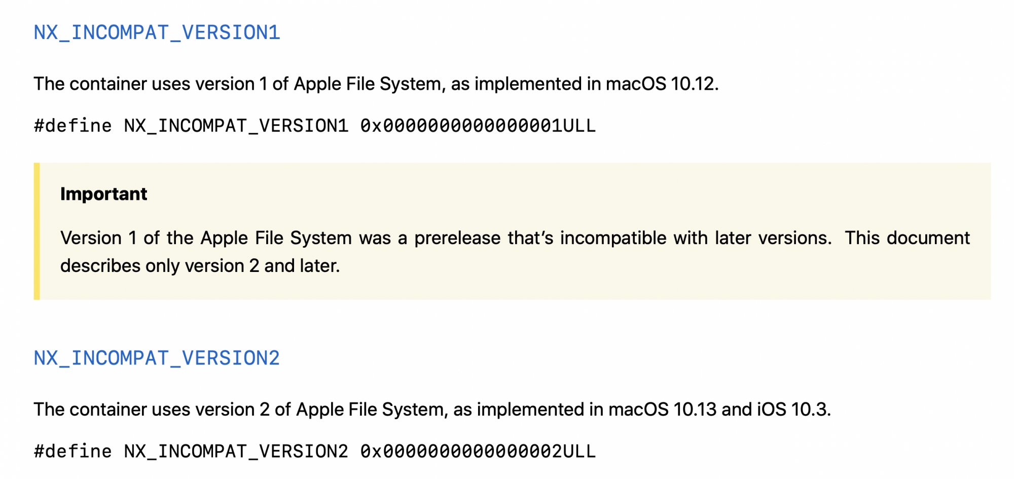

No. APFS has been version 2 since High Sierra. There is literally no problem making an APFS container in Catalina or newer and installing Mojave.

I'm curious, have you done any research at all. APFS was present in later Sierra patches, everything after that was version 2. There have been no changes in compatibility beyond that.
