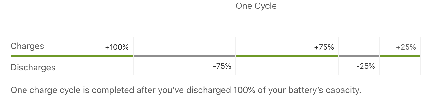

Image taken from: https://www.apple.com/batteries/why-lithium-ion/
If I drain my battery 10% ten times, then charge it to 100% I'll consume 1 charge cycle. If I drain my battery 50% twice then charge it to 100% I'll consume 1 charge cycle. If I drain my battery from 100% to 0% and charge it to 100% I'll consume 1 charge cycle.

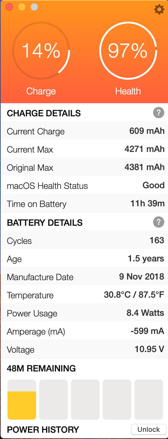

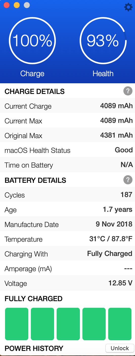

I've noticed a huge reduction in my battery health since updating and enabling this function. First was a loss of 3% within 3 charge cycles and now some 2 months later I've lost 7%.
I started off with 100% which has progressively eroded, while my usage hasn't changed that much. I'm on power while working in the day and off for the rest of the day, sleep at night. I'm a little concerned that this is going to deteriorate at this rate which will leave me with a device that will need to be constantly connected to power.
I'm impressed that at 1.5 years I'd still got full capacity this would fluctuate between 97% and 100% if I let this run to within 5% when I noticed the percentage was dropping. Now this is like a cliff edge!
I've reset the SMC which has had no effect, I'm going to closely monitor this as I'm a little suspicious that the battery health feature may be not having the desired effects in real life as on paper.
