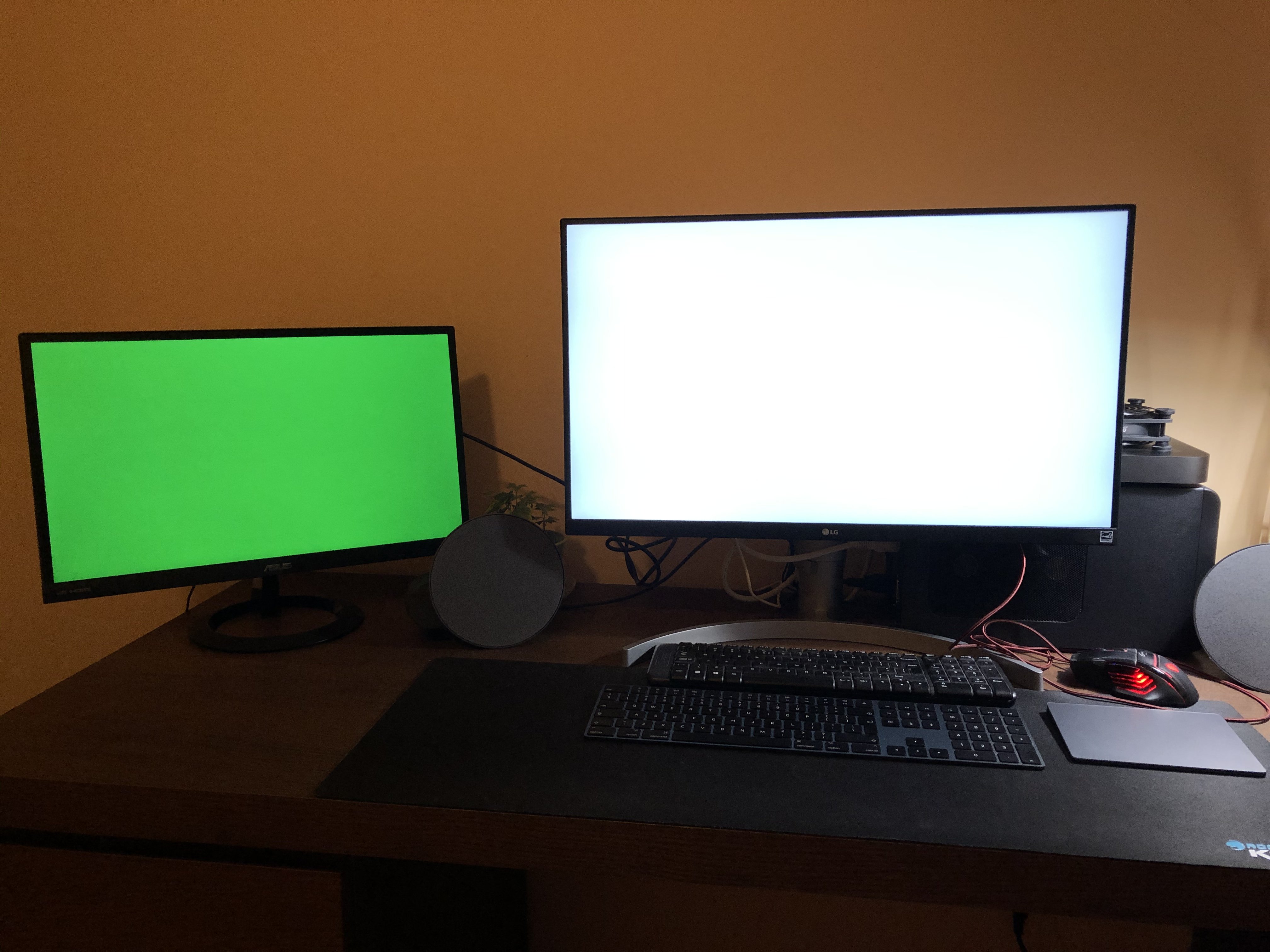

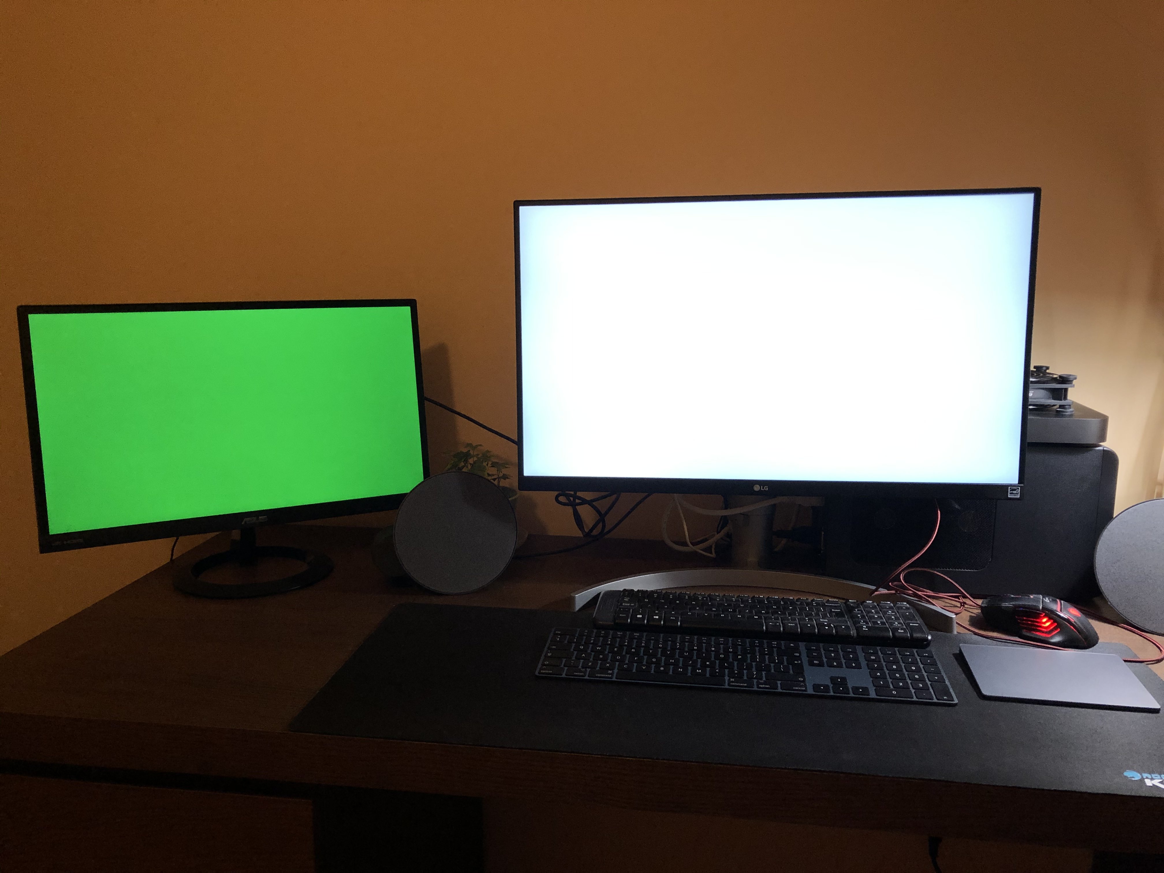

10. Tried to go back to 21 inch as main screen - 21 via iGPU goes green, 27 via eGPU goes white (Photos later in this topic).

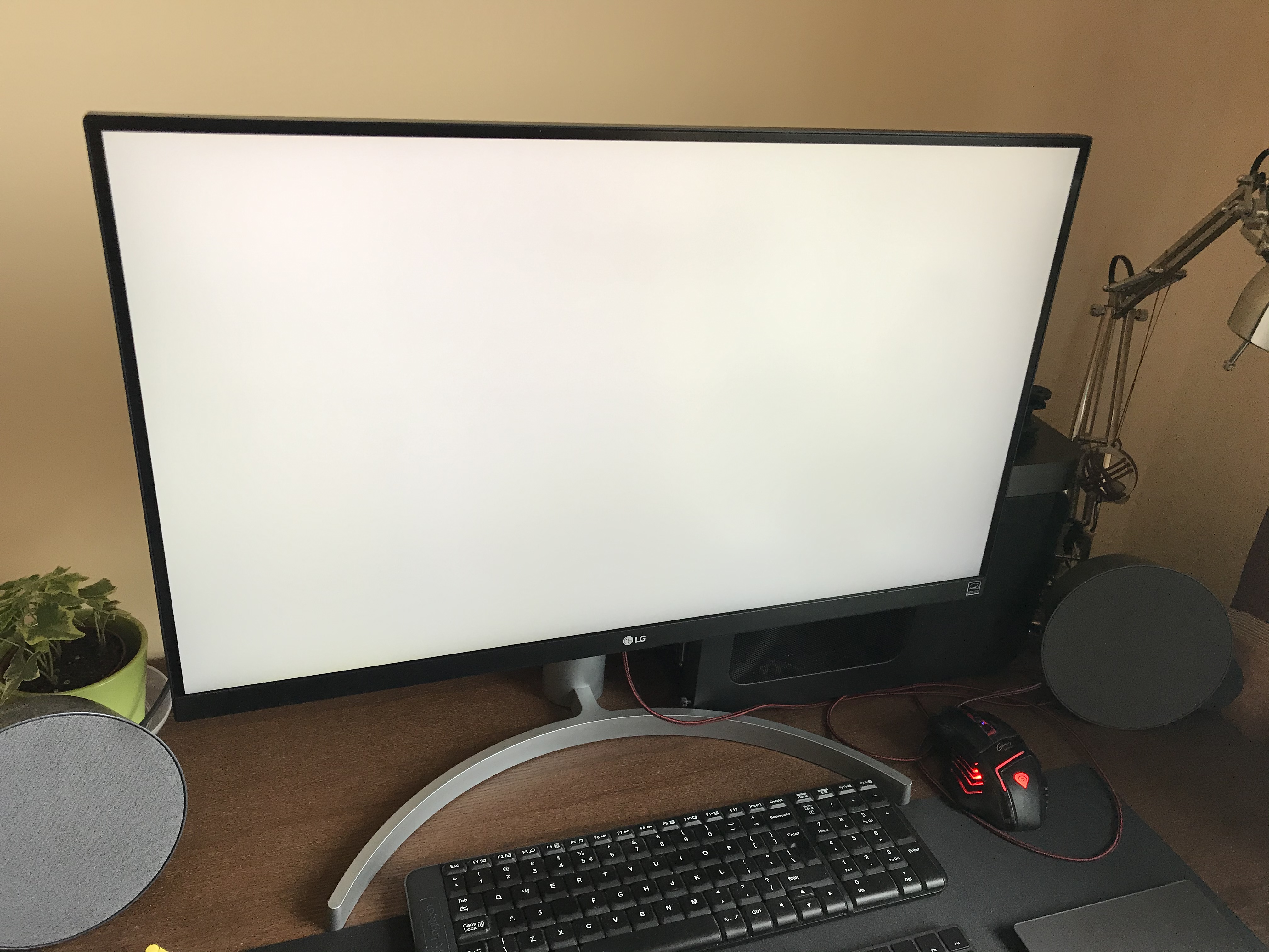

After updating to Catalina on firsts boot I had white screen and everything frozen at that point. I force shud-down machine and it worked for couple of hours. Today I can‘t boot into macos - on eGPU mac freezes in white screen after apple logo, on iGPU - nothing is even displayed on my monitor. I was on call with support, they hear about it second time, no fix yet. Display should work as I managed to get into safe mode via HDMI on iGPU two times. Tho It’s unconsistent, couple of times it fails to boot into safe mode before I manage to get in.
Now I try to make bootable USB, but have no idea how I’m gonna instal macOS while my screen does not work.
If any of you experienced this please share tips. I can’t boot into recovery on iGPU, on GPU I loose display after 5 minutes of installation, there’s “no signal”.
EDIT: Monitor is LG 27 inch 4K

Tried Everything, seems like a problem with LG model. I plugged my very old 21 Asus monitor via HDMI, this one works - I’ll try to downgrade to Mojave if I’m able to....

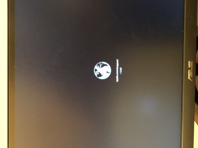

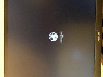

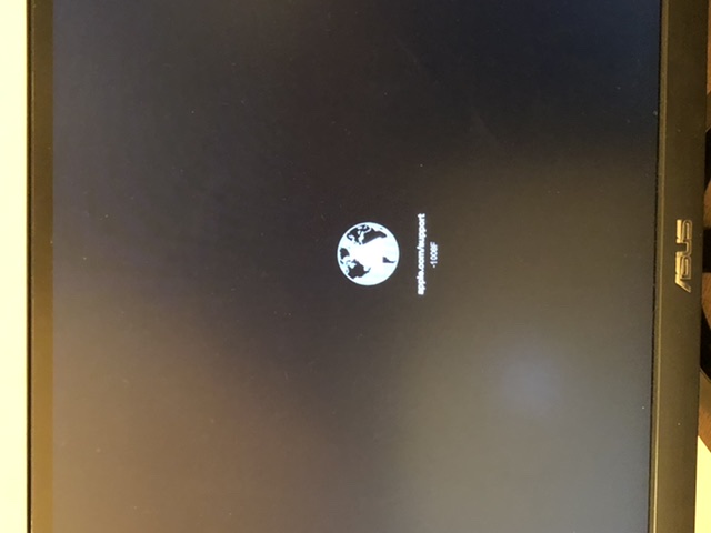

I managed somehow to install Mojave. Happy seeing ssystem installed, while I lost some recent files that fortunately were not important, I turned Mac off and plugged my old setup so eGPU and LG monitor. Turned Mac on - no visual. Tried again - Imidiately after apple logo I got spinning globe and prompt to chose my WIFI. After doing it it fails to do anything more. So I turned it off, plugged old monitor because it worked and - same problem, spinning globe and failing connection.
I’m trying to figure out what to do now. If I fail to push through with Mojave I’ll call apple support again. This is horrible.

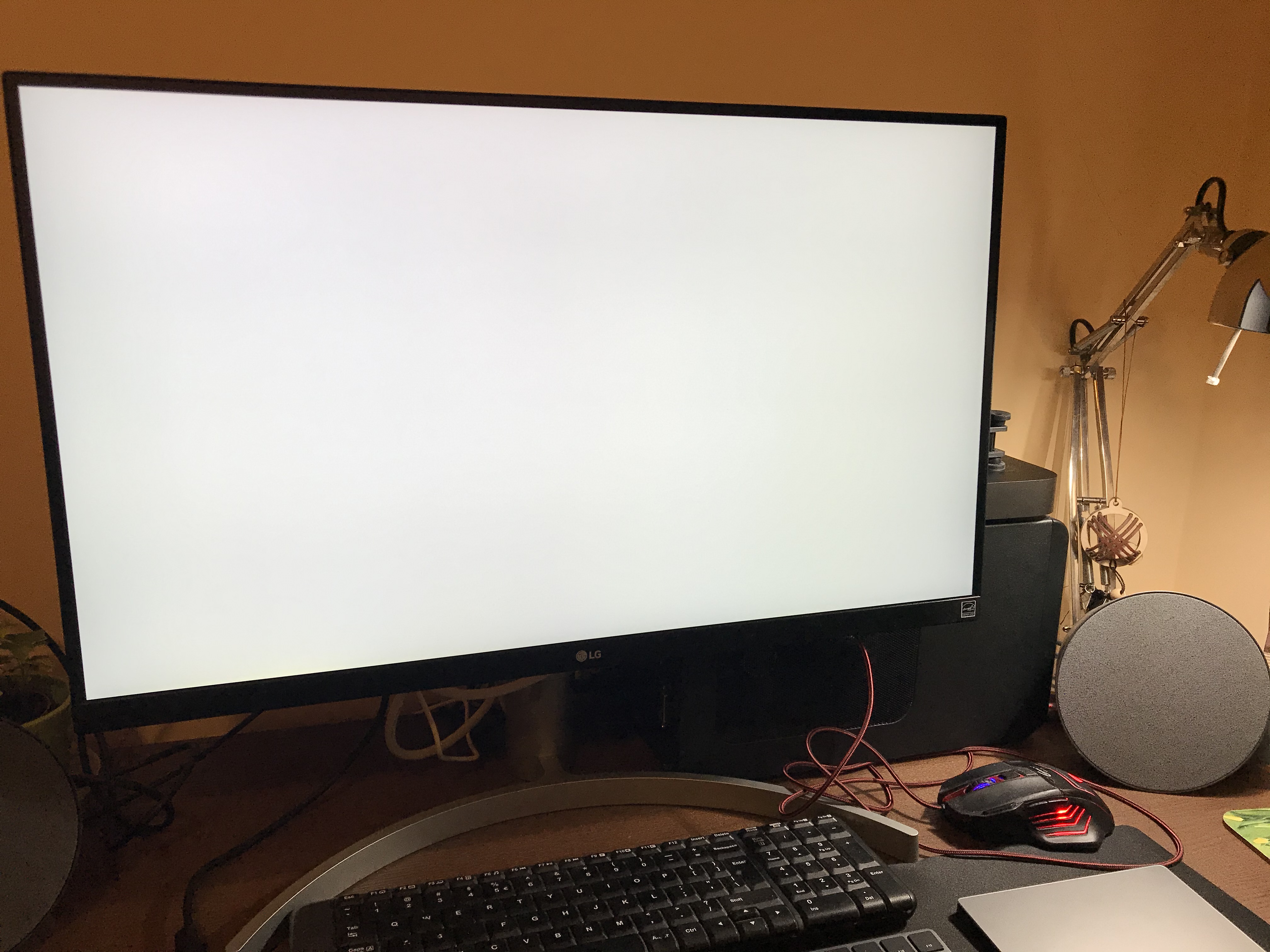

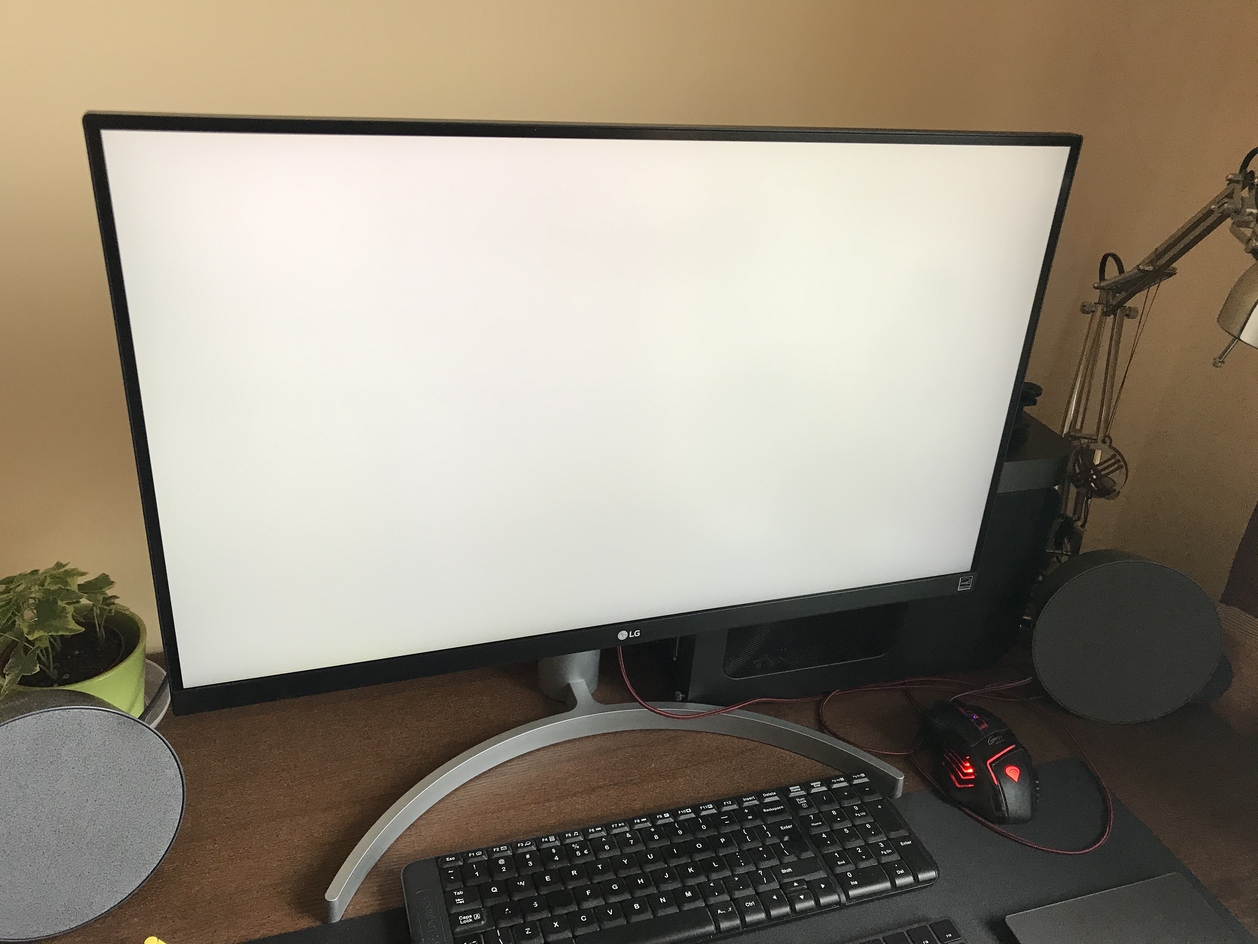

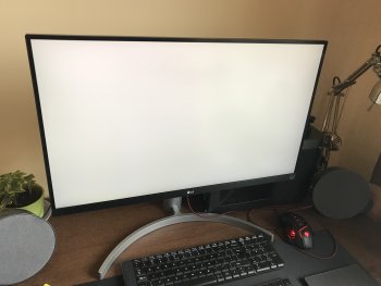

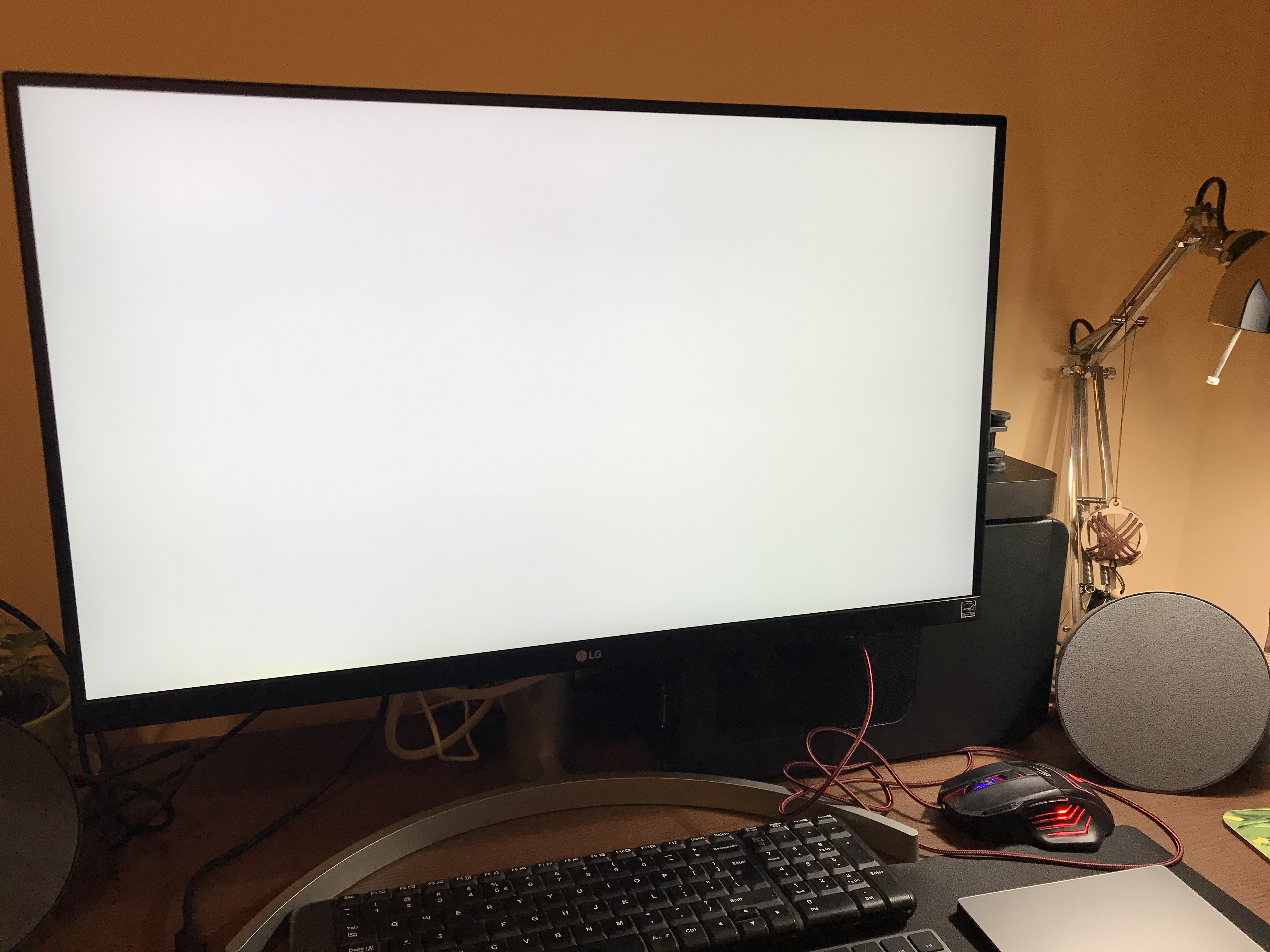

Mojave in, welcome back white screen. I am able to get into login screen, put password, it starts to log in and then white screen like this:
Waiting for apple support to help me go through this mess, it’s unbelievable how bad it is.
EDIT: look at all this fun on the second photo.

Try to unplug the monitor cable and plug it back in after a few seconds. Does that clear the white screen?
I’ll definately try it when back home for weekend and get back to you with info whether it works or not. Need to try both resetting NVRAM before reinstall and your proposal.
Unpluging and plunging monitor again didn’t help, even switching between outputs doesn’t help. Using 2 monitors doesn’t help. Only way I can use this thing in macOS is with 1080p monitor on iGPU.
I’m gonna try triple NVRAM reset before install if I have spare time in coming days.
