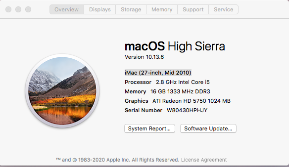

I am new to this forum and I would like to know if it is possible to install the Catalina on my old iMac 2010
I have attached the specs of my iMac
Many thanks

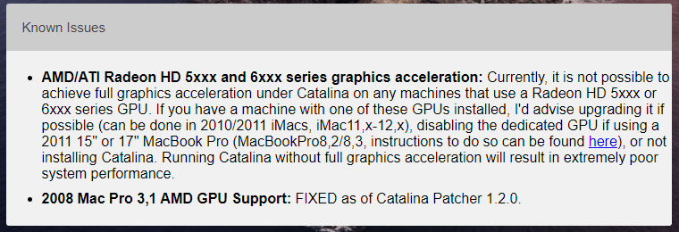

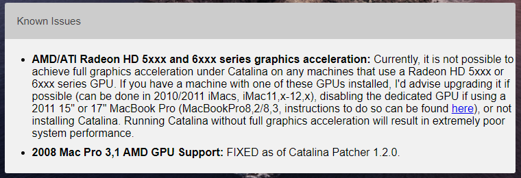

I've checked the link and still seen Dosdude's warning about HD5xxx GPU. Better use OCLP approach. Post-install patching of OCLP have fixed the issue with HD5xxx GPU.
