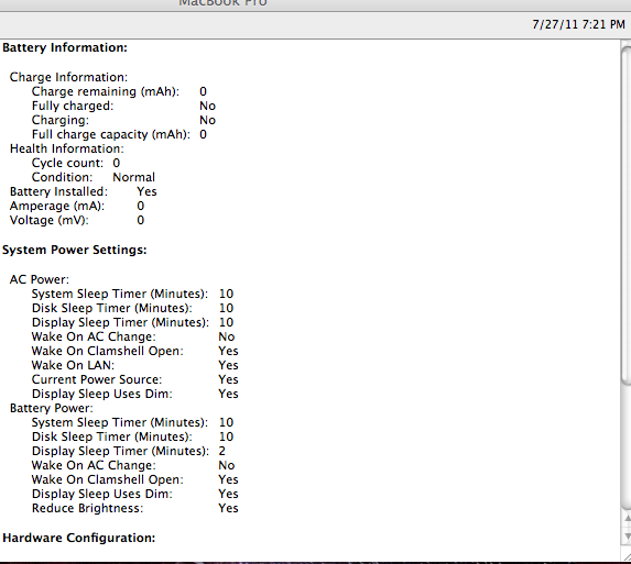

Here is my screen shot of mbp
I am attaching my screen shot
If I'm not mistaken, Apple laptop batteries have one or more controllers and circuitry that manage it. This could be what's fried if the battery is seated properly and all the contacts are touching.
i checked the pins they look fine. no problem
one thing i have noticed is, if the battery is in the mac there will be only one green light appears in the bar when its connected or not connected to the power adapter. also the same thing happened when i popped up the battery and started my mac. I did reset the SMC no use
yes its always green on the mag safe connector
i was talking about the green light on battery status. i see only one dot
