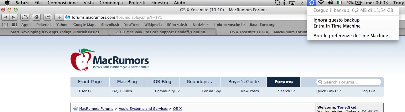

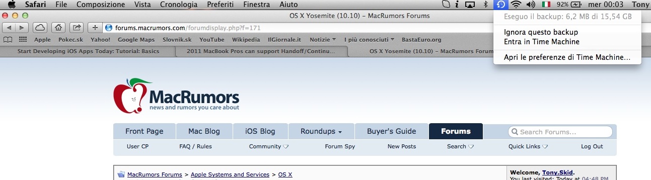

Before reading your suggestion, I did something different: restarted with recovery HD, repaired permissions on Mavericks (lot of corrections on iTunes. Maybe because Yosemite had updated iTunes?), then restarted. TM backup now is ending, with a total of 4.98GB. Still, very odd.... Any idea?
Quote myself, only to tell that.. here we are again. After the update from dp7 to dp8, this is the results from the TM backup in 10.9: more than 15Gb...!
To recap, Yosemite is installed in external usb drive, is not included in TM backup, and now the drive with 10.10 is not connected to my MBP.... while work in Yosemite, I always disable the internal Hard disk (ejecting it from the desktop) right after the icon shows up in desktop.
