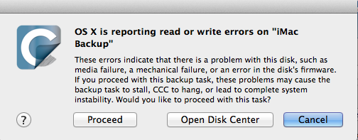

I get this image when I go to backup a drive.
Can anyone help me out here?

CCC is working. It appears there's a problem with your drive, very likely hardware.
Any suggestions on what I need to do here or how I fix my drive?

Try using Disk Utility to repair the disk. Note that "repair disk" is different than "repair permissions". If that doesn't help, your drive may be dying.
I wouldn't interrupt an action in progress.

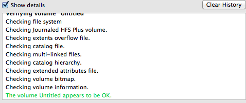

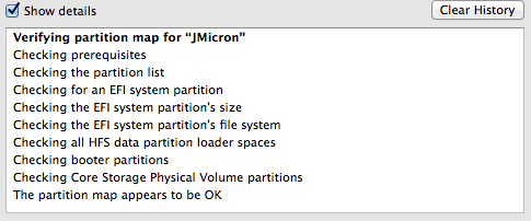

I had just started so it didn't get going...this is what it reported.
Cold it be the firmware as indicated in the original message?
Yes, it could be one of many possibilities. It will require some troubleshooting, eliminating possibilities until you find the culprit. CCC is very reliable software, so unless you've damaged your CCC installation, I would look to other possibilities. If you've verified the disk, I would reformat it and try again.

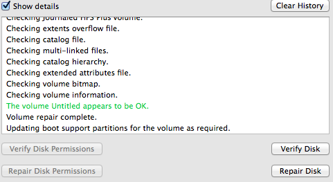

Last check I just ran...should I re-install CCC? I've been using it for 2 years without an issue.

I second what GGJstudios wrote above.
This has nothing to do with CCC -- it indicates a problem with the drive.
But you seemed to have resolved that problem with the drive as you indicated in your replies above.
If the drive is checking out OK with Disk Utility, I'd try to run CCC again.
What results do you get now?

I'm sending it back to OWC since they cover it under a 3 Year Warranty 🙂
It still won't back up no matter what I do.
