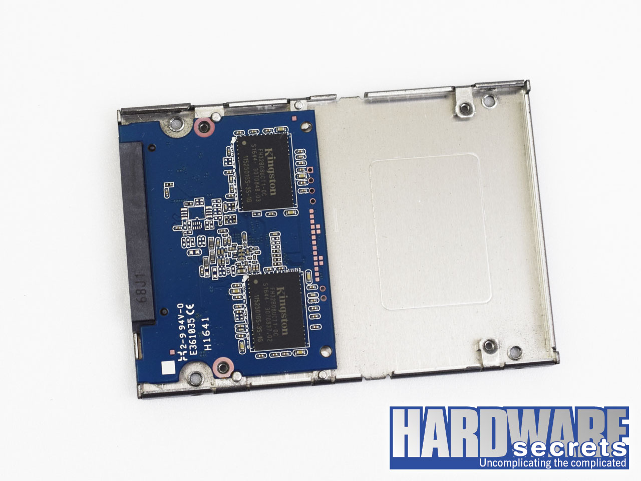

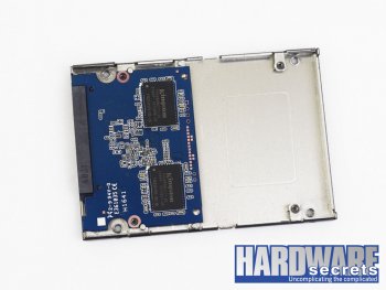

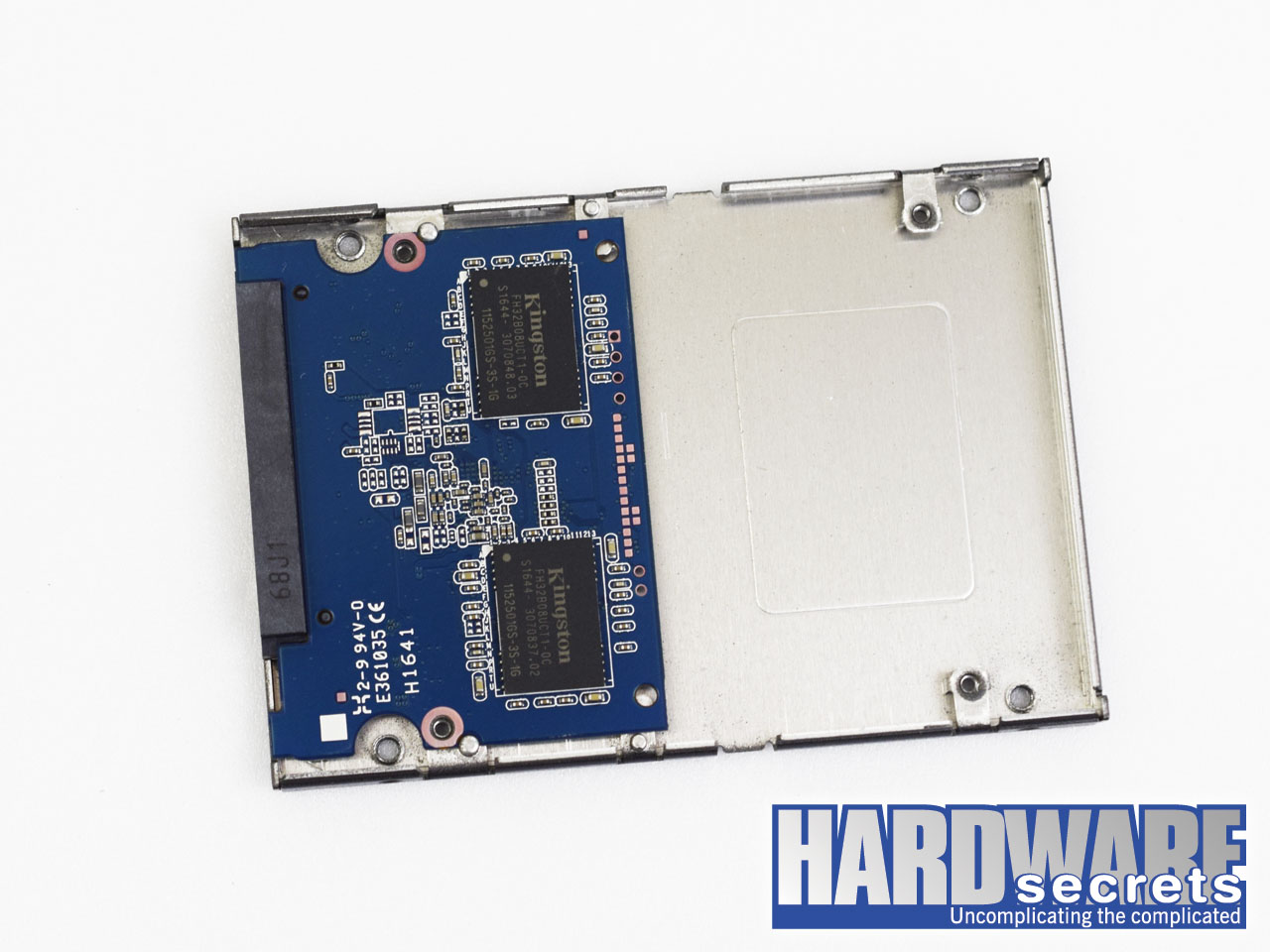

It's very unlikely now but there was at least one SATA SSD, whose circuit board only occupied the first third/half of the casing that covered it. With a suitable adapter, it would fit into most PowerBooks/iBooks. Almost all, however, are too long hence mSATA. You could try opening up the casing of the SSDs you have (you will lose your warranty) and looking inside. You might just strike lucky.
Here's a current contender, if you have one spare: The ubiquitous Kingston A400 series SATA drive.
