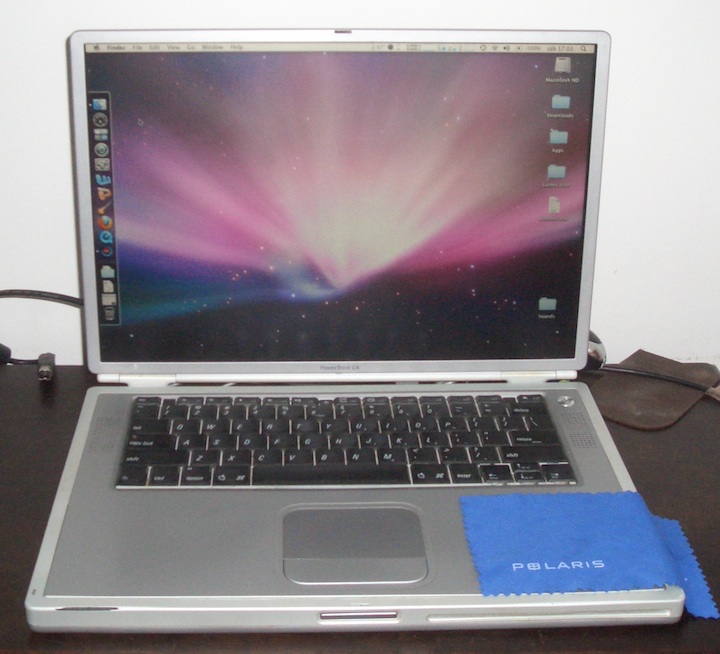

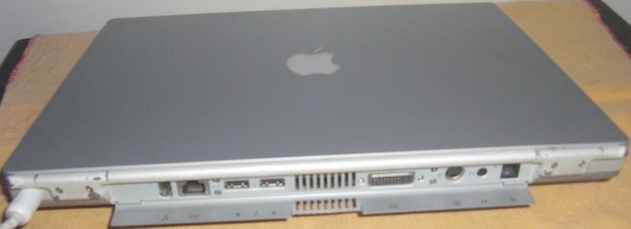

Ya that all sounds like a power related deal. Glad you got it up and working. You should post a few pics of it! I love my TiBooks, but they're pretty rough. I wish I had the 1GHz one you do. The L3 cache really makes these things screamers.
Pics? You want pics? OK.
I also have a 1 GHz 12" G4 ans a 1.5 GHz 12" G4. They both are in great shape and perform flawlessly.

Yes, it is in great condition. There is a small place with what appears to be a mark from the keyboard. I haven't tried to clean it because I'm not sure what household stuff will work and I haven't been able to find any commercial products for laptop screens here in Brazil. So, until I know what is safe, I'm leaving it as is. There's also the slight wear mark on the left edge below the keyboard but I haven't found the right shade of anything to fix that, either.
My two 12" G4s are in even better condition and I'm really happy with the performance of all of them. I haven't tried anything really intensive like running Final Cut on them for video editing, but everything else is great. Watching movies or web surfing works like a charm. I even use Yahoo messenger with a web cam and no worries. 🙂

Both of mine have some pretty serious keyboard marks on the screens. Particularly the 867MHz on the left side. I am pretty sure thats why starting with the AlBooks Apple started putting the little rubber stoppers in the upper corners of the screens. Looks very nice though! Now I found my 867MHz TiBook to feel faster than my old 867MHz 12" Powerbook even though the 12" had faster RAM etc. How do you think your new TiBook compares to your 1GHz 12" machine?
The mark on my 15" PB is on the upper left quadrant, too. I use a microfiber cloth to cover the keyboard on all of them when I close them.

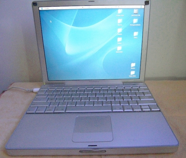

I have also bought some sick-on pads similar to what you put on the bottom of furniture legs and cut them into small squares. I stick these into the upper corners so they cushion the lid and put enough tension on it that it doesn't feel "loose" when closed. Se the attachment of one of the 12" PBs. I may put a couple of more to either side of the latch, too so there will be no flexing when closed.
