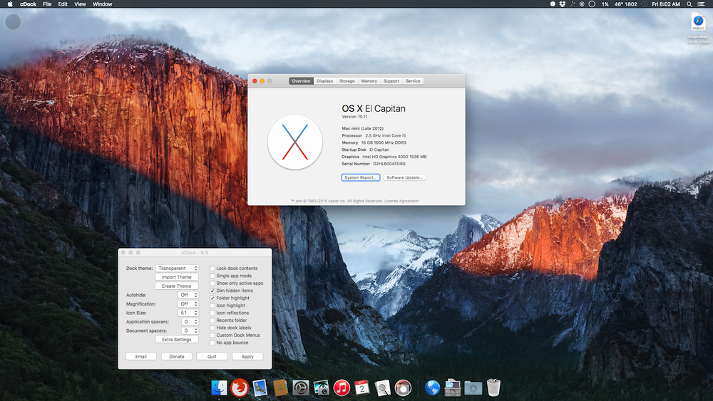

cDock works just fine in El Capitan, but you do need to disable SIP to install it, after which SIP can be re-enabled.

I disabled SIP and cDock works. Figured out if I somehow managed since... uh... Tiger? until now, I can continue living without SIP for a bit longer.

cdock 2 does not work properly (I am unable to set transparency), in spite of doing all of the above steps and deselecting reduce transparency in 'accessibility'. This said, cdock 2 does allow for some functionality in El Capitan, just not transparency (which is actually why I have it)

Transparency working here with cDock2, MP 2009, so there maybe something in your system causing that. Try disabling SIP, deleting the old cDock prefs, and reinstalling? cDock 2, and Liteicon 3.6.1 both work with SIP off, and cDock continues to work even after reenabling SIP.
