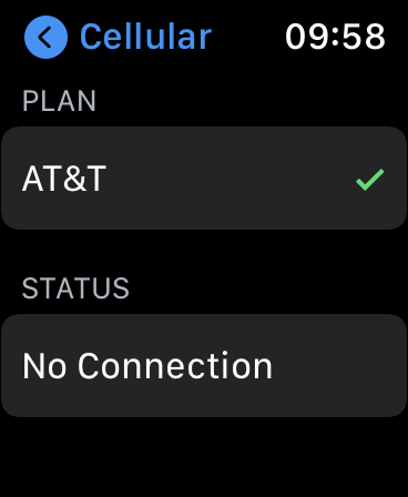

I can still call and receive phone calls but no Siri,dictation, walkie talkie, or iMessage.
I’ve done the usual, rebooting both the phone/watch, signed out of iMessage, then erased all the data and repaired it. It doesn’t seem like an AT&T issue since the phone calls still work but an OS7 issue? On the watch under cellular status: “not connected”. Anyone have any other suggestions beyond just waiting for it to be fixed?
Yeah mine says no connection under settings as well.

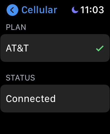

No issues with my Series 3 GPS + Cellular on AT&T. My plan shows correctly in the iPhone Watch app and in Setting > Cellular > my plan shows connected. Under Settings > About, I have Carrier settings 13.0.2 and all device IMEI, ICCID, MEID, MAC, BT, Firmware, SEID, and EID are populated correctly.

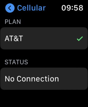

Ok, I tried all of the above, got the numbersync confirmation email, but same number as before and I didn’t get to choose a different one. Before doing all of this I checked my account and it was still the same, mine is still Unlimited Mobile. After doing this, the account appears the same. What should my next step be, try to get an AT&T rep that is an Apple Specialist? Is the goal to get my watch under the Apple Watch Access vs where it is now?
Or should I erase everything on my watch, not keep the cellular plan, and set it up as a new watch with a new plan? Then later go back to AT&T and try to get the refund for the activation? But honestly if that will get this working correctly I don’t care about the activation amount.
I just checked the settings and it’s working now. Disabled Bluetooth on my phone and WiFi on the watch and I can access data on the watch when connected to LTE again.
