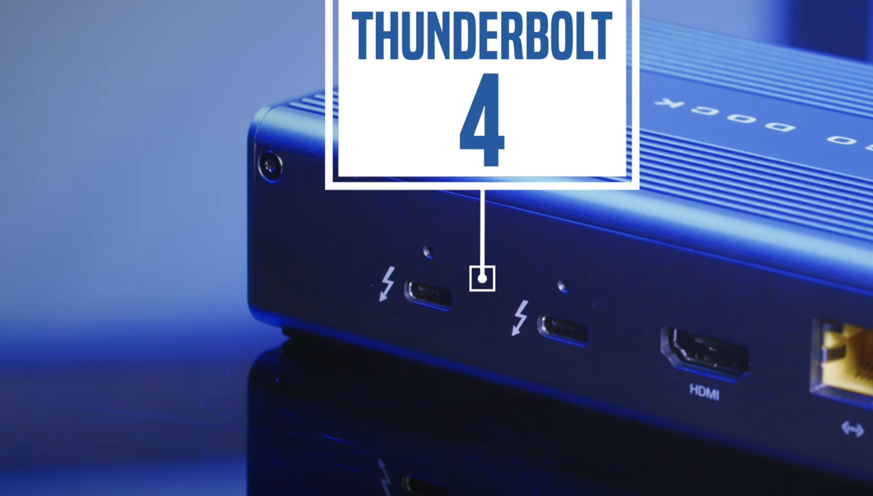

$400 and still only 2 Thunderbolt ports? Is CalDigit the only company that understands that people don't just want hubs for as many legacy ports as possible? We want the most possible performance out of a single Thunderbolt port. That means more Thunderbolt ports on the hub. I don't care that my MacBook Pro has 3 TB ports on it...I only want to use one, for convenience. The Hub I use has to accommodate/enable that, or there is no reason for me to buy a hub.
But there is 3x Thunderbolt ports. 🤭

Can all these companies please stop releasing premium price docks that aren’t 10G ethernet. There’s no excuse.
It's actually a limitation of Thunderbolt 4. This dock is a Thunderbolt 4 dock where one of the downstream ports is converted to HDMI.
10Gb Ethernet requires 2 lanes of PCIe Gen3 throughput. The current thunderbolt 4 chipsets only give 1 lane of throughput as a compromise to having the “hubbing” functionality of thunderbolt 4. Thus you will not find any thunderbolt 4 dock with 10GBASE-T. Thunderbolt 3 lacks the hubbing functionality (more than one downstream Thunderbolt port), but provides x4 lanes of PCIe Gen3.
If you're looking for a Thunderbolt 3 dock with 10GbE, they have an updated version of their Pro Dock (that is now fan-less and has new ports) here: https://eshop.macsales.com/shop/owc-thunderbolt-pro-dock
TLDR: you will never find a Thunderbolt 4 dock/hub with 10GbE due to actual thunderbolt limitations. Your best bet is something like the Thunderbolt 3 Pro Dock from OWC.

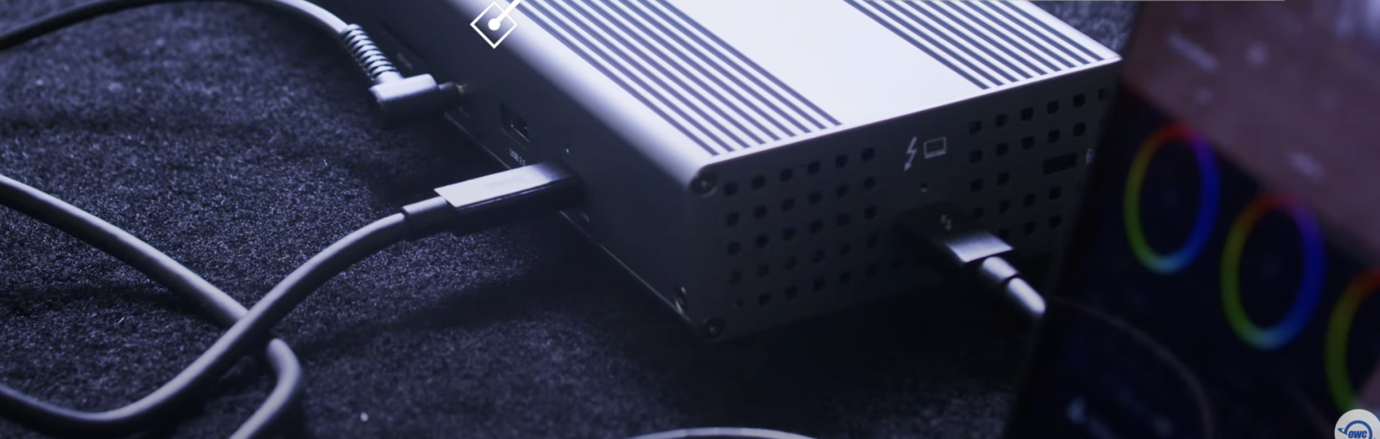

I think most of the commenters are missing the point.
"Thunderbolt Go Dock"
It's a full-featured travel dock.
If the device name didn't explain it, the photo at the top of this post should. Purpose-built for travel, it replaces your MacBook power brick, includes fully-powered accessory ports, and takes advantage of the Thunderbolt chipset to make the entire bandwidth available across all of them. Unlike USB C port multipliers and hubs, which are almost always gimped to share what a single USB C port can offer, it does not require you to use your own—extra—power supply.
As TVV already mentioned, OWC offers a solution for just about every "competing" product mentioned in the comments above, whether it be TB4 hubs that provide additional Thunderbolt ports, desktop-centric TB3 docks that offer a larger array of ports, or professional-level devices that throw 10Gb Ethernet into the mix. Every company out there is just putting together a combination of features that work within the TB3 or TB4 spec, and this device fills a specific role and looks to be a major convenience for travelers with higher performance needs than a dongle, but would rather not shlep yet another giant brick with them to plug into a wall.
As far as I can tell, this is a one-of-a-kind solution and—for me, at least—it's exactly what I have been looking for.
That's a limit of the Goshen Ridge chip. There aren't a lot of (or any other) options for Thunderbolt 4 peripheral controllers. One option would be to put more than one Thunderbolt controller inside - some eGPUs do that.
An exposed PCIe lane is not required for hubbing - downstream Thunderbolt controllers will have their own PCIe lanes. I think Intel just didn't want to make the Goshen Ridge big enough to expose 4 PCIe lanes so they decided to expose only 1 lane to at least provide some PCIe functionality.
Alpine Ridge has: DisplayPort, two Thunderbolt, 4 PCIe.
Titan Ridge has: USB, DisplayPort, two Thunderbolt, 4 PCIe.
Goshen Ridge has: USB, three Thunderbolt, 1 PCIe.
1 PCIe lane should allow near 8 Gbps. While you won't see 10 Gbps speeds, it's still better than 2.5 Gbps.
Does anyone make a 10Gbps USB to 10 Gbps Ethernet adapter? That might give better than 8 Gbps (while you're not transmitting to/from a USB storage device or camera or whatever). Again, they could put a second Thunderbolt controller inside to expose more PCIe lanes.
I don't think there are any other TB4 peripheral controllers that will do hubbing and expose at least 2 lanes of PCIe Gen3. And I'm not aware of any USB based 10GbE chipsets. One advantage of using the Aquantia PCIe chipsets is that the drivers are already built into MacOS since Apple uses those chipsets in their Mac desktops.
Yes, one way to do it would be two have two thunderbolt controllers inside a device. But that would also raise the cost on an already expensive product. And also it would mean that the max device chain would be 1 less (which isn't an issue, just need to make sure users are aware I guess).
Hopefully the next version of Thunderbolt solves this issue.
