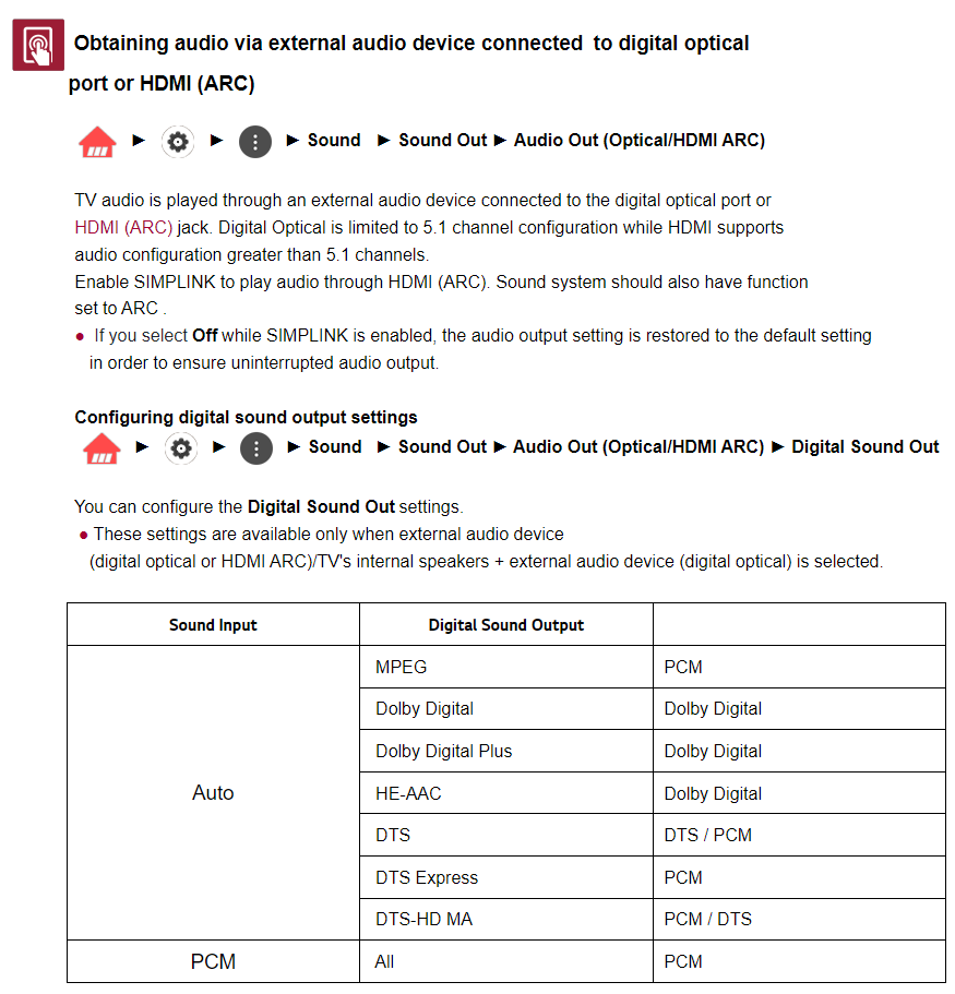

My TV is an LG C9 65" OLED with ARC set to passthrough. It's also set to eARC but that's immaterial since my AVR (Sony STR-DN1040) doesn't support it. I did wonder, as you say, if the TV is re-encoding DD+ LPCM from ATV to bitstream before sending it out to my receiver for decoding. But if that is the case then why does it only do so for Apple media? 🙃😂

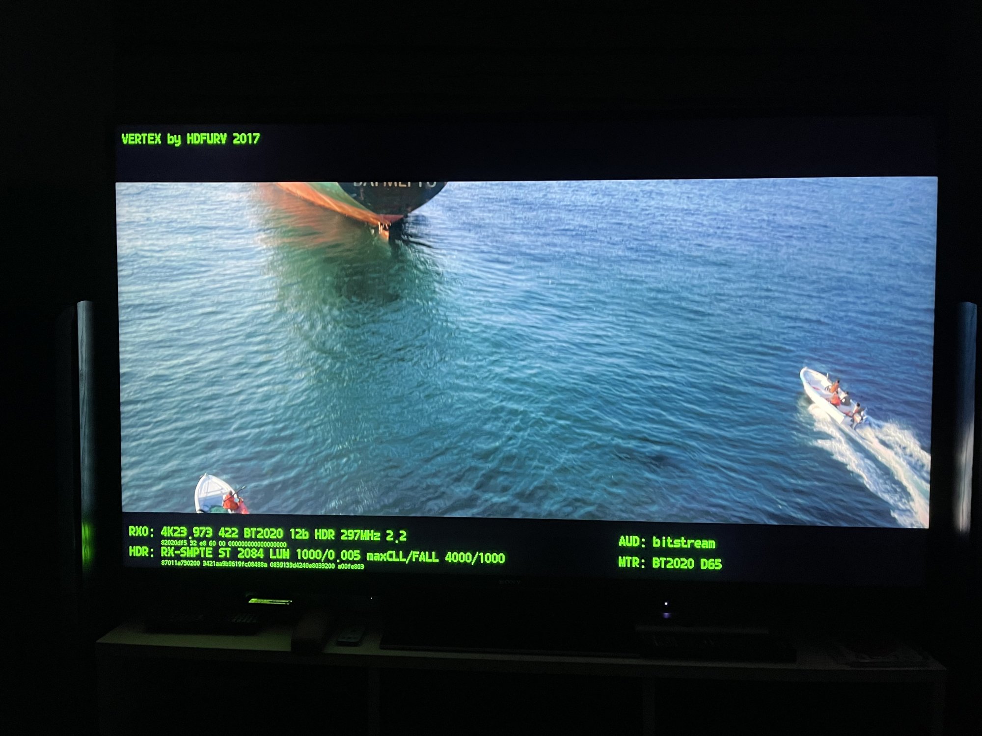

Funny that you say that you also have Sony AVR. I used DN1080 previously, now it is a ZA5000ES.
I did never see DD+ being reported from aTV. As I said earlier, I never used it via ARC, only directly connected to HDMI in on the AVR.
PS even regular ARC can be configured to output DD+ (at least on my Bravia that's the way you could get Atmos from the internal apps to AVR).

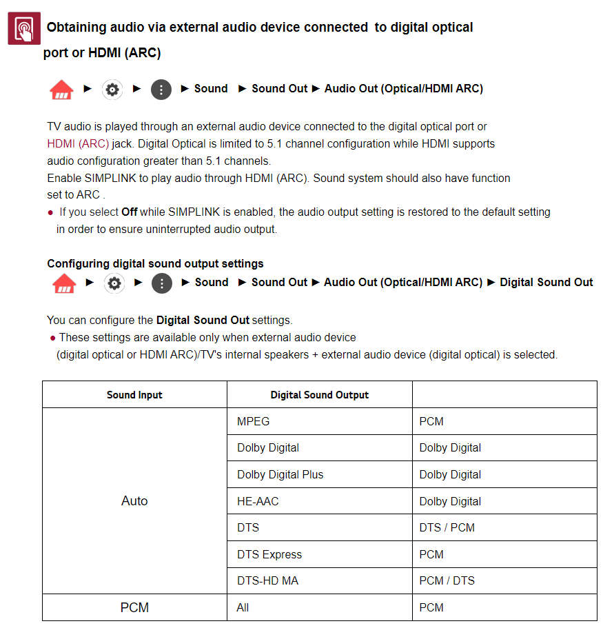

PPS According to LG help, the ARC output might be re-encoded to Dolby Digital, as I understand. I also do not know anything about LG tellys, but I wonder, how will it behave if aTV sees it as Atmos-accepting sink and you ask it to forward received MAT2.0 (LPCM) signal to ARC? If you ask why only Apple-sourced content, then the reason may be as simple as it has proper Atmos metadata set in MP4 headers.

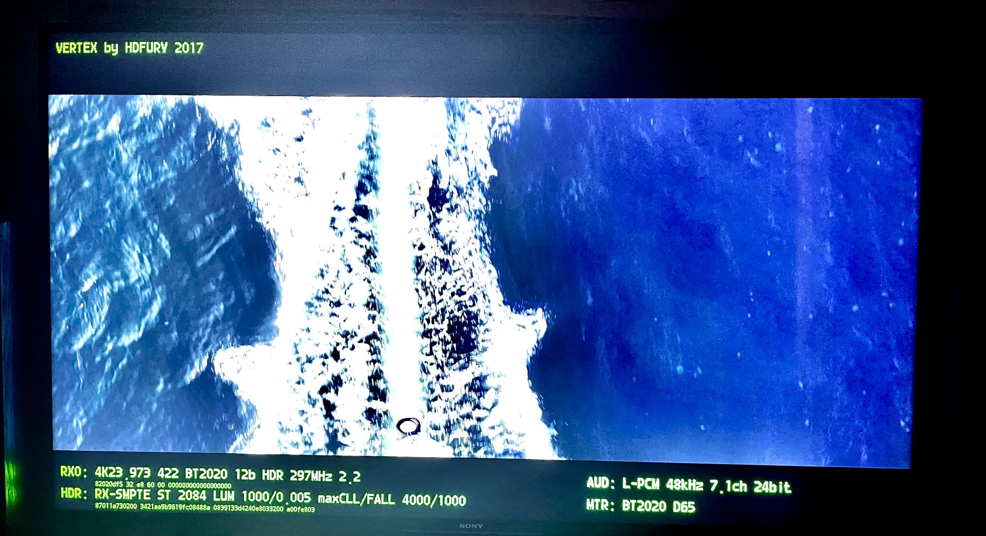

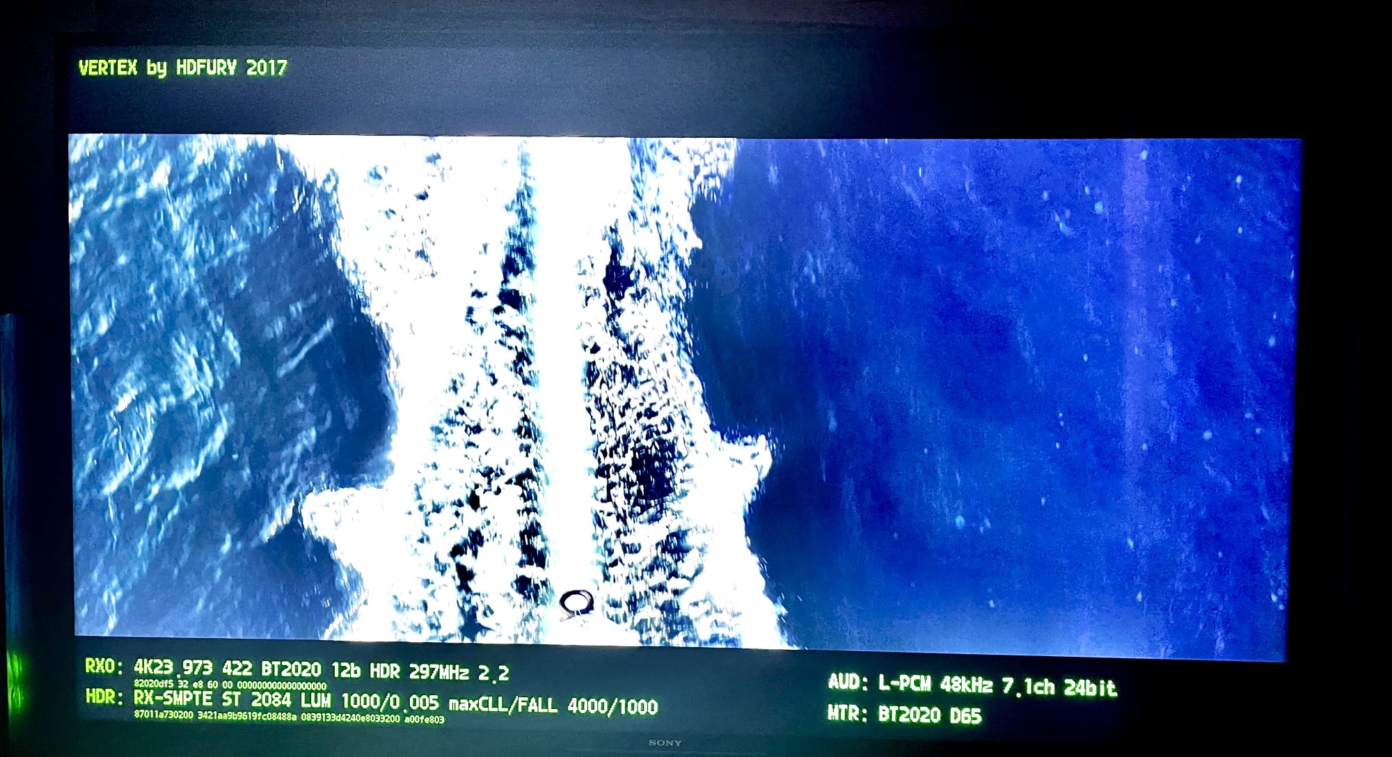

This is what I see, when playing DTS:X MA audio from Plex server via Infuse client on tvOS.
According to my calculations, this amounts to:
48k x 8 x 24 = 9216kbps
Here's the MediaInfo report of the source file:
