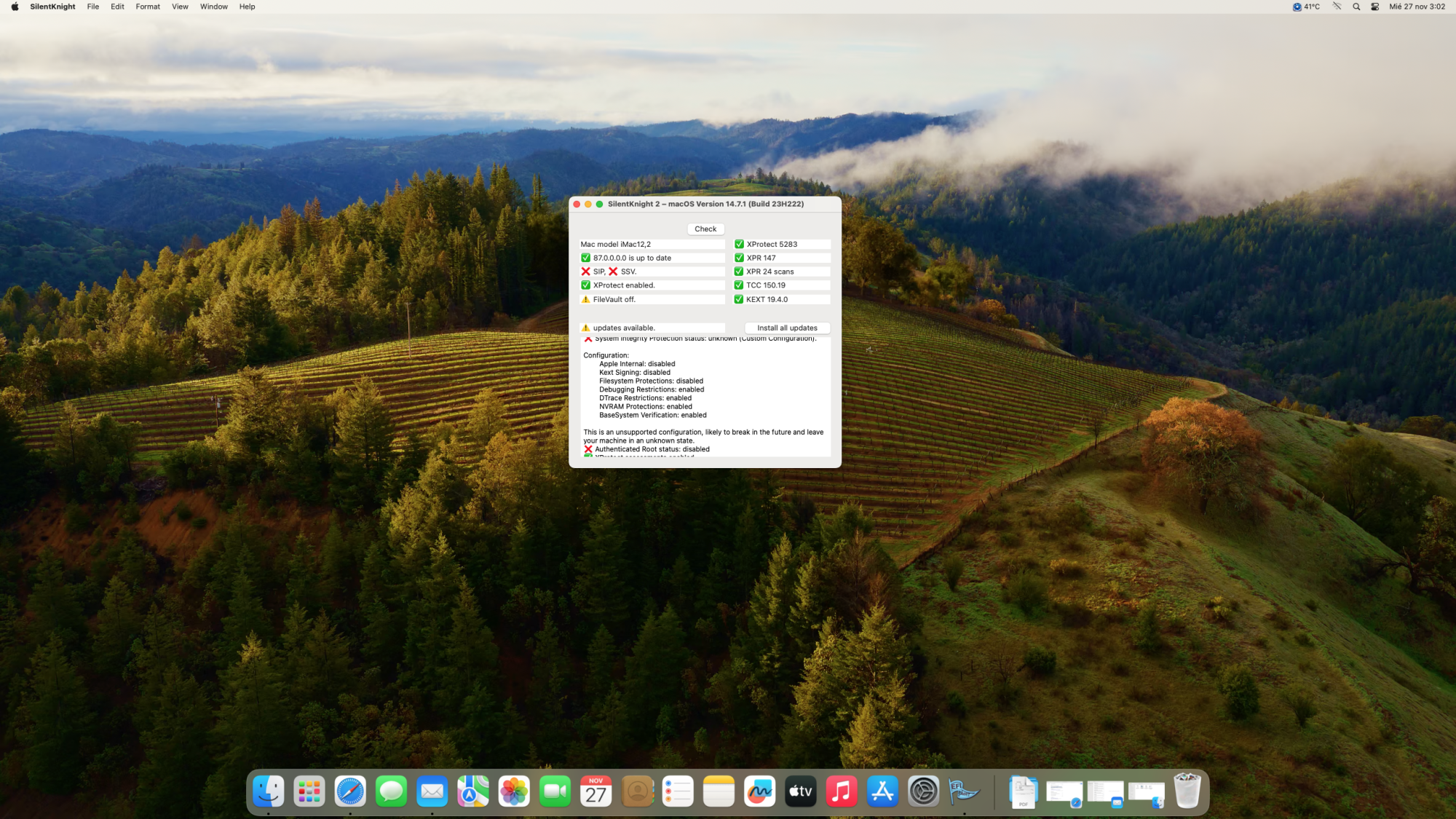

It is a Mac from late 2011 with an i7 2600 processor and Quadro K610M by nikey22 1GB graphics.
When I bought it it came with i5, 8GB, and the graphics that I mentioned, I expanded it, now that I have a little money I want to expand the graphics, to continue working since my finances are not very good and I cannot buy another computer new.
I have thought about the Quadro K5000m 4GB graphics card, it actually meets what I need but I don't know if it will be implemented well with my imac, say that I have the 3-tube heatsink in the absence of using a dremel machine to reduce the heatsink since the k610m has a copper die on the chip.
My bootRom is updated.
I don't know if what I show you is enough to plug and play.
I don't have much knowledge but I can defend myself in something.

So you have only thought about the K5000m, not yet located it.
By default, Quadro K5000m is a card for Windows laptops and not fully supported by iMac.
Therefore it needs to be flashed with a modified vBIOS to make it funtion like a native Apple card like the description I quoted above.
So, you need to verify that with the seller of the card first.
The seller might also sell the modified 3 pipe heatsink as well, if you are not the DIY type.
I've carved my own 3 pipe heatsinks with an angle grinder, another time with a power drill with so-so result. I don't have Dremel.
