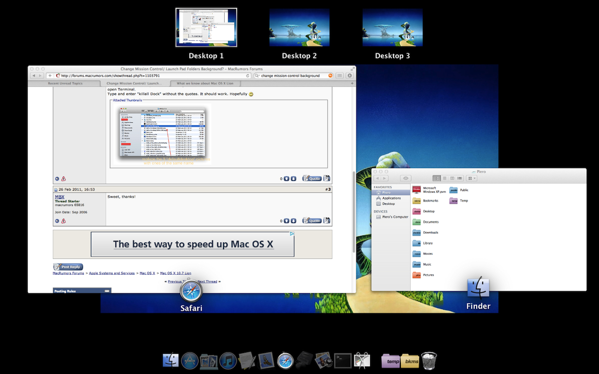

Time to bump this great tip! Worked perfectly for me (though I only found one 'default desktop' file to replace in my resources folder).

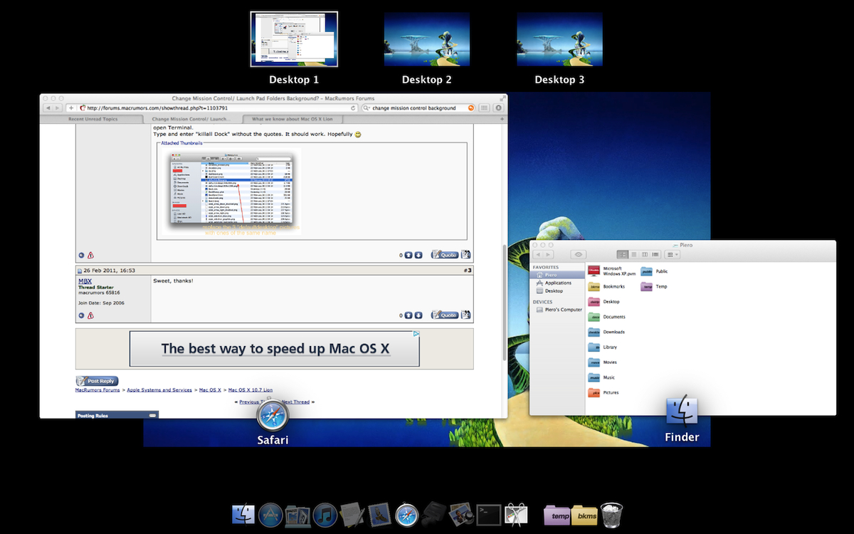

if you are using a laptop and have it connected to an additional monitor, you must choose your wallpaper to accommodate the larger size of the two.
For example, the screen resolution of my MBP is 1680x1050 and the resolution of my HD monitor is 1920x1080. When is chose a wallpaper at 1680x1050 for the defaultdesktop.png, mission control appeared tiled on the larger HD monitor and looked terrible.
I tried again with a resized 1920x1080 wallpaper and voila!, mission control properly displays a full size wallpaper on my HD monitor and works just fine on my MBP.
**Note: If you choose a larger resolution wallpaper than your MBP supports, it will not compress to fit, but rather bleed the image off the top and right side. This means that images or patterns can be cut off or look uneven depending on the wallpaper
