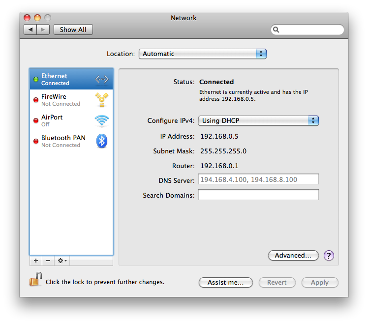

Tried the info and still no result? Screen shot below
Screen shot 2011-08-03 at 22.24.57
So this is what your network config looks like when plugged into the device you want to set up?
If so, the router config address is 192.168.0.1
edit - why are those dns servers in there also - get rid of them. the router should do that automatically for you
