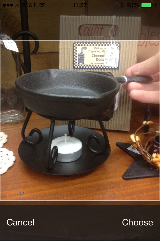

When picking an image with a UIImagePickerViewController, a crop box like in the attached image shows up.
I don't want to force the user to pick a square image. I'd rather let the user pick their own aspect ratio, if easily possible, or if not, I want it to just use the original aspect ratio of the image.

Edit: Acceptable Fallback Found
I found this answer which clearly states that the problem is because I have allowEditing set to true. I set it to false and it removes the editing screen altogether - an acceptable fall back.
