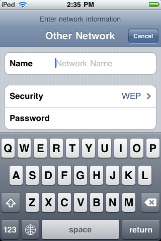

When you go into settings you should be doing:
settings->wi-fi->other - unless yours shows up -> then enter the info. (like in the screen pic below)
Name: SSID of your net, that the router Broadcasts (or not if it is hidden)
Security: choose what you are using WEP you say
Password: the "key" you have set on the router for the devices to use.
